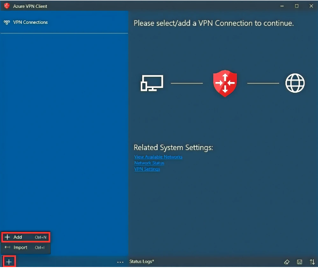

    • To Import VPN client profile configuration files: On the VPN client app, select Import. User's image
    • Browse to the profile “azurevpnconfig.xml” file and select it. With the file selected, select Open. Specify the name of the profile (if you want to change it) or you can leave the default and select Save. User's image
    • Select Connect to connect to the VPN.
    • To manually add the profile:
    • On the VPN client app, select + Add.
    • Fill out the connection information. Select Save.
