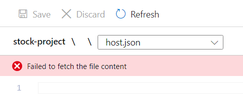

The host.json file looks like this:

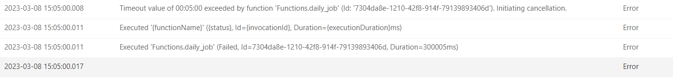

Even though the functionTimeout is set to 10mins, the Function still times out at 5mins.
I've tried Stopping/Restarting the Function App and also re-publishing the Function. Nothing works. Hoping someone has come across this before and can help out.

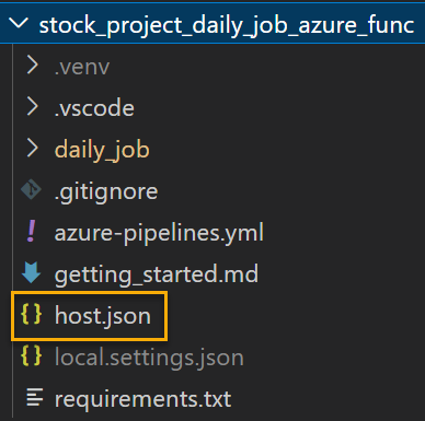

  1. TP 146.1K Reputation points Volunteer Moderator
    2023-03-09T03:12:32.2966667+00:00
    It appears you don't have it at the root of the function app. Please try setting it there and test, similar to below:
