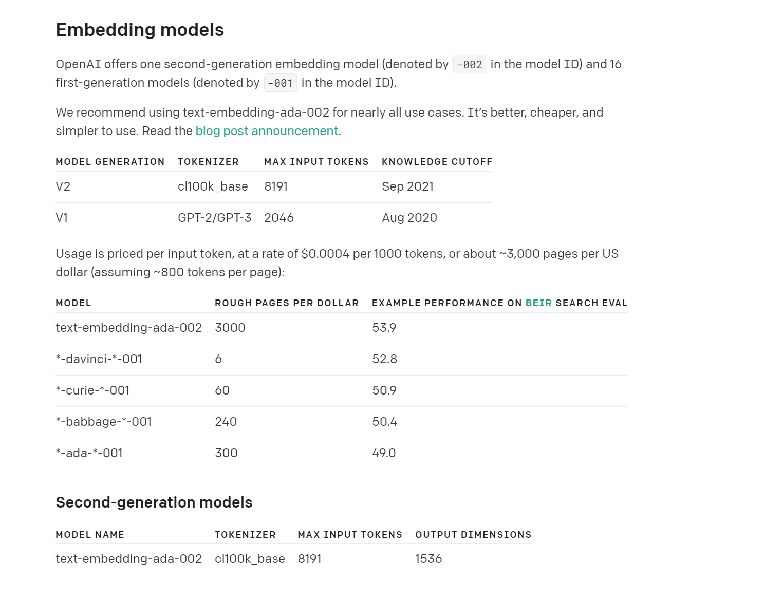

Hi I'm starting to use Azure OpenAI embeddings text-embedding-ada-002 model, but it seems to have a limit of ***2048 ***tokens, while OpenAI says it should be 8192.

    So you are mentioning the limit for Azure open AI and Open AI are not the same. For Azure Open AI, the limit of text-embedding-ada-002 is 2048 but for Open AI is 8191.
    I think this is the current product limitation and I am sorry for any inconvenience at this moment. Azure Open AI Service is releasing step by step and it is not fully releasing as for now.
    I find some supportive information shows currently in Azure documentation as below -
    The Azure Open AI is not releasing the same tokens limit as Open AI at this moment. I have forwarded this feedback to product manager to confirm any plan to release the same limit as Open AI, and I will let you know once I have any response.
