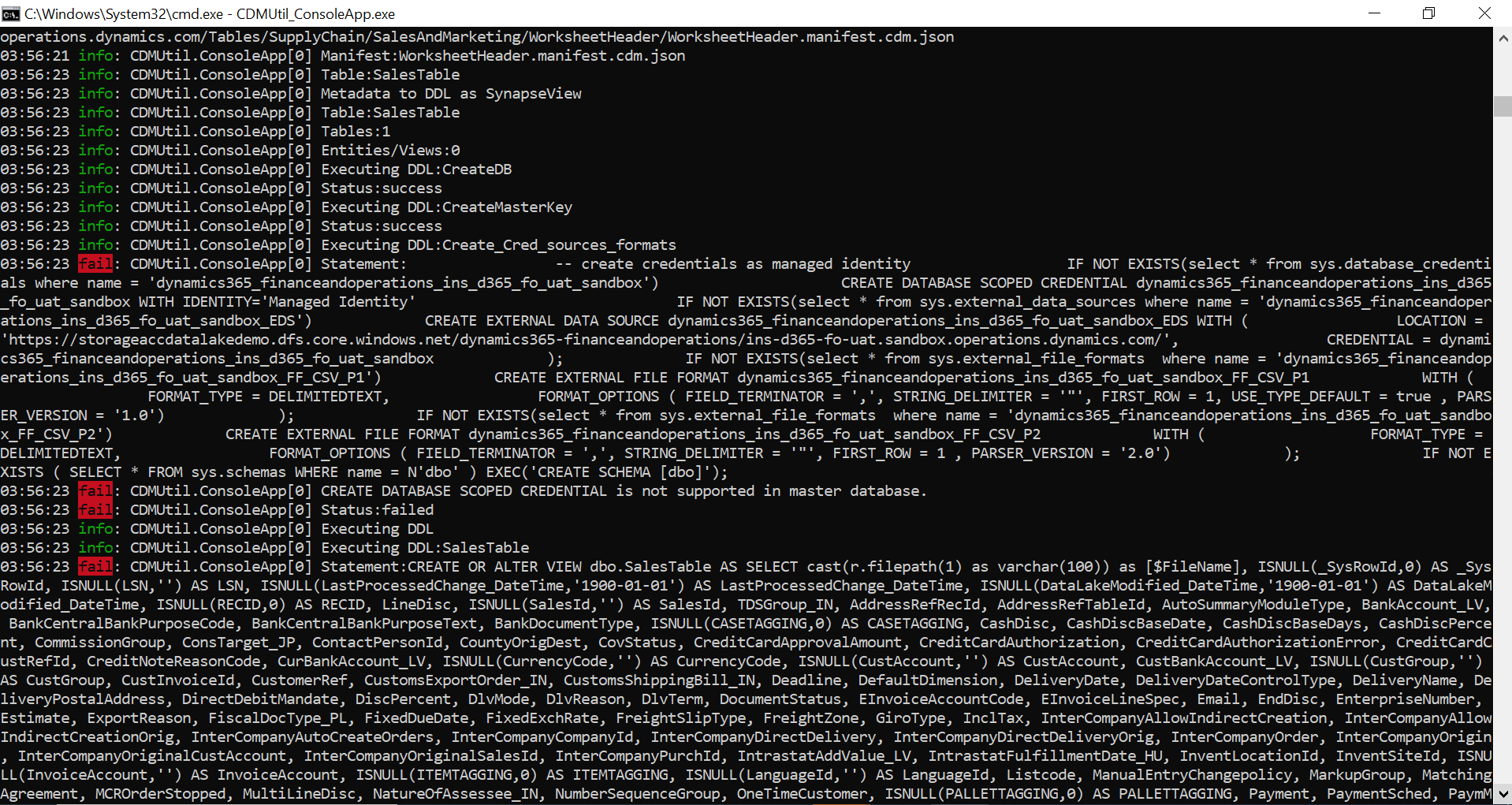

I had tried to create a view for D365 F&O data in synapses using CDMUtil_ConsoleApplication.exe to convert the manifest data to DLL . I got stuck with the below error . It has mentioned to create credential in manage identities and CREATE DATABASE SCOPED CREDENTIAL is not supported in master database. Please help on this User's image

    This tutorial - Analyze data with a serverless SQL pool will help you to create a database in the sql serverless pool and then you can create CREATE DATABASE SCOPED CREDENTIAL (Transact-SQL).
    You may checkout the MS Q&A thread addressing similar issue.
