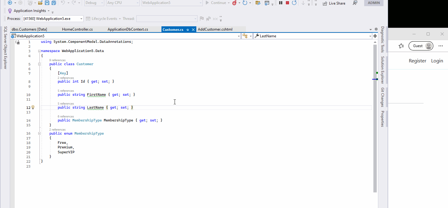

    By default, for the Enum property, EF core will create the column with int type:
    For example:
    Using the following class, after generating the table via EF core migration, the customer table will generate a MembershipType column with int type. When insert new customer, the MembershipType column value is: 0, 1, 2 ...
        public class Customer
            [Key]
            public int Id { get; set; }
            public string FirstName { get; set; }
            public string LastName { get; set; }
            public MembershipType MembershipType { get; set; }
        public enum MembershipType
            Free,
            Premium,
            SuperVIP
    The result:
    If change the enum as below:
        public enum MembershipType:byte
            Free,
            Premium,
            SuperVIP
    After migration, the MembershipType column is tinyint type: When insert new customer, the MembershipType column value is: 0, 1, 2...

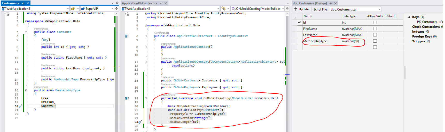

    If you want to save the enum value as string format. You can add the value conversion in the OnModelCreating method, like this:
            public DbSet<Customer> Customers { get; set; }
            protected override void OnModelCreating(ModelBuilder modelBuilder)
                base.OnModelCreating(modelBuilder);
                modelBuilder.Entity<Customer>()
                .Property(u => u.MembershipType)
                .HasConversion<string>()
                .HasMaxLength(50);
    The result as below: and when add customer, the MembershipType column value is: Free, Premium and SuperVIP.
