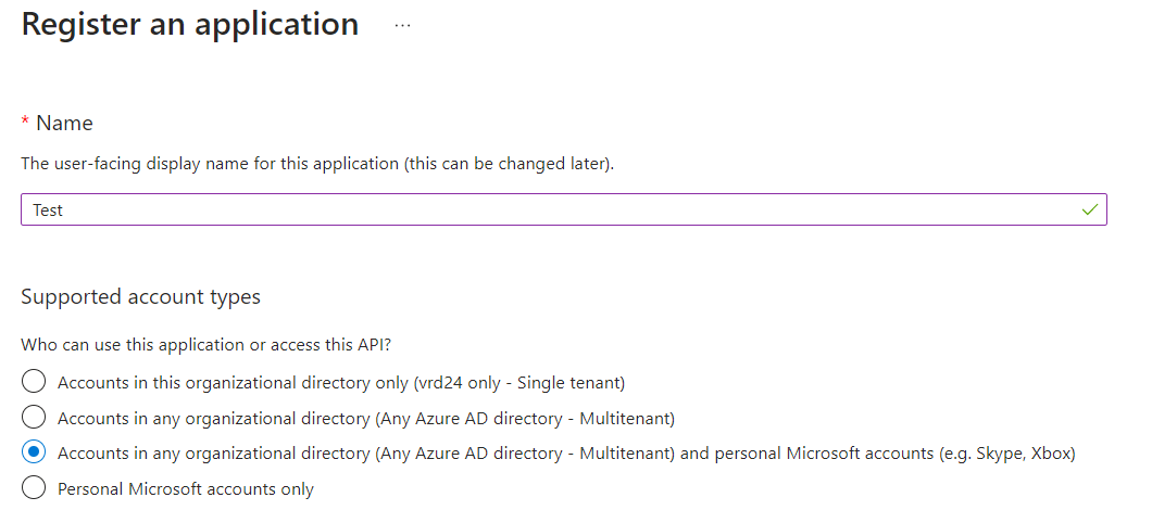

    I understand you are trying to authenticate all the Microsoft users to your application, but your application currently authenticates users in your tenant.
    The reason your application is not allowed to authenticate all Microsoft users is that you have registered your application as single tenant which only allowed accounts in single directory only.
    You need to register your application as multi-tenant with below supported account type:
    which will allow the audience to sign in from other tenants as well as users with Microsoft accounts. If you have sign in audience with Microsoft accounts, you can select 'Personal Microsoft accounts only' as well.
    In the OAuth request, {tenant} value in the path of the request can be used to control who can sign into the application. Valid values are common, organizations, consumers based on the type of audience.
    Reference: https://learn.microsoft.com/en-us/security/zero-trust/develop/identity-supported-account-types
    Hope this will help.
