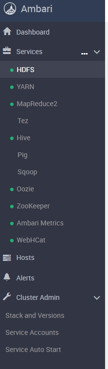

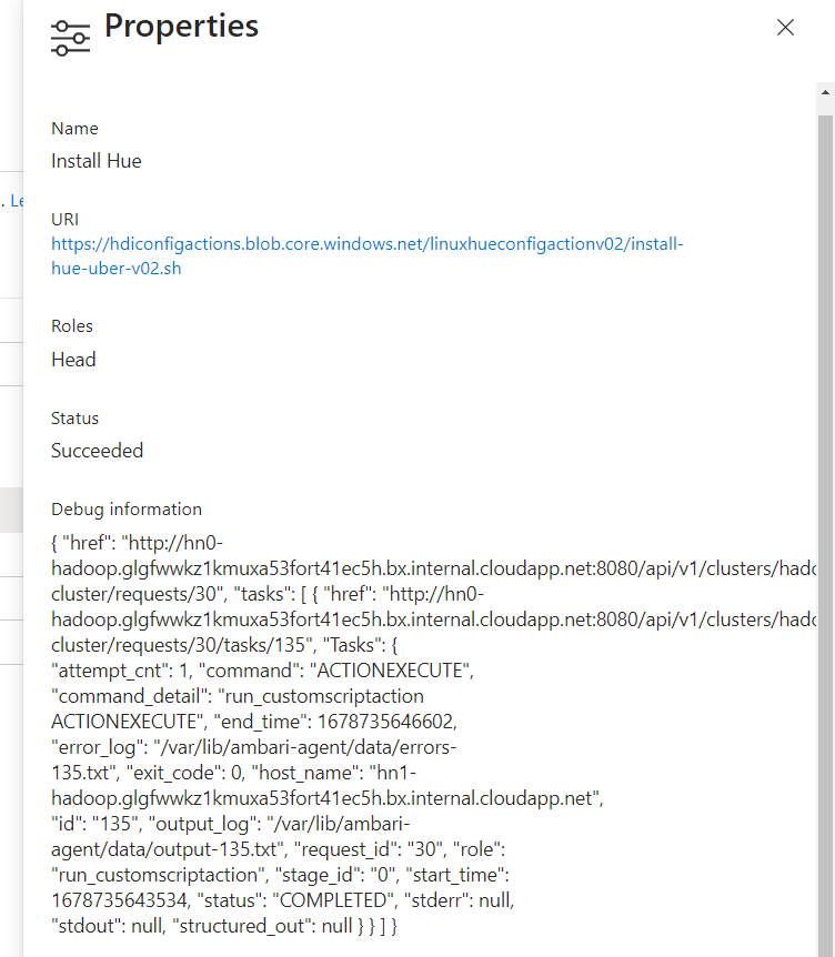

I created a hdinsight (hadoop) cluster and I used the script action to install hue.
The installation was Succeeded:
But I was unable to find hue service or url in ambari
Could you please help me?

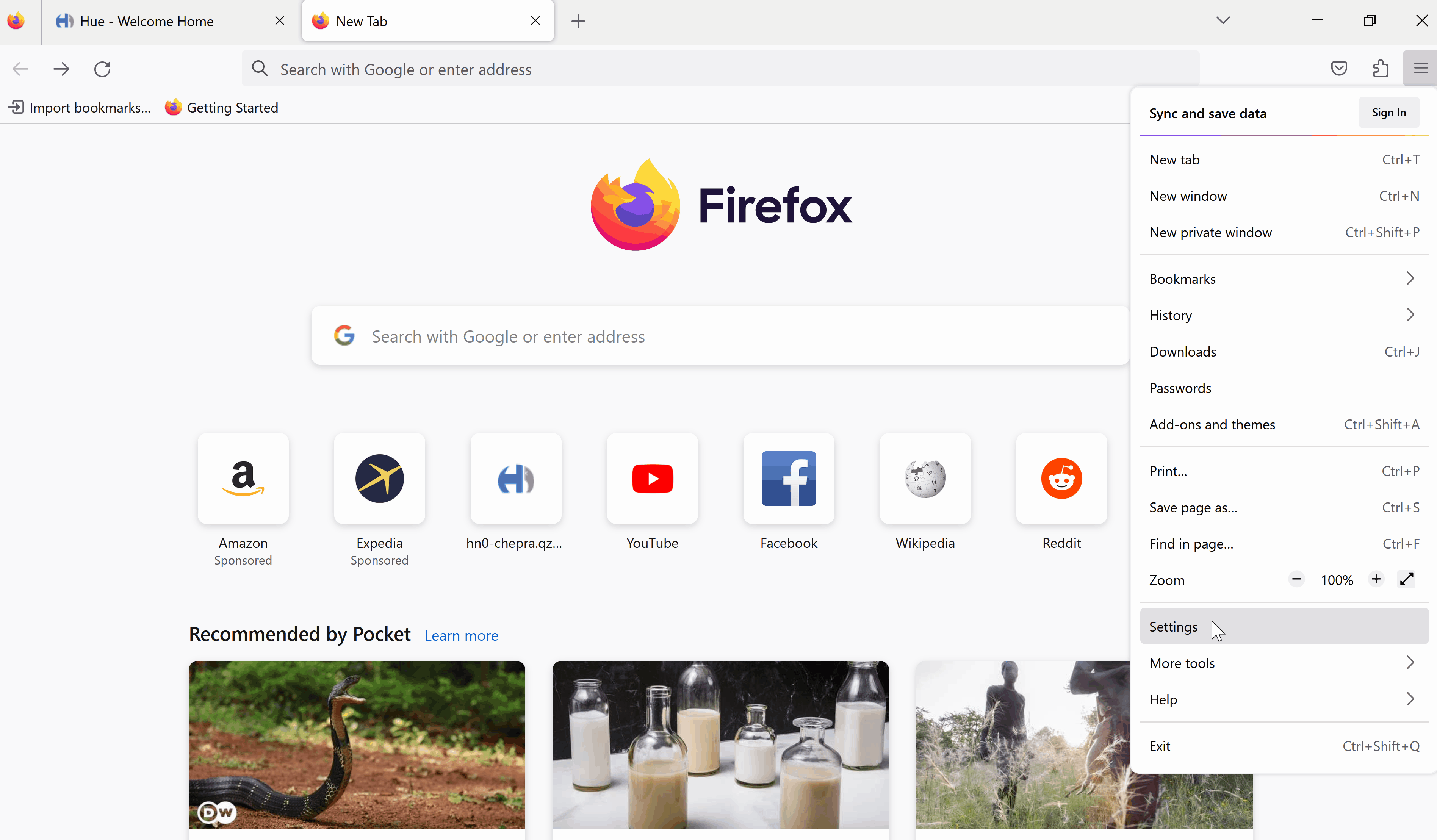

    Step1: Use the tunnel from your browser.
    Note: We recommend using Firefox web browser to follow the instructions below.
    Open Firefox browser => Settings => Scroll down => Network Settings => Configure SOCKS v5 proxy.

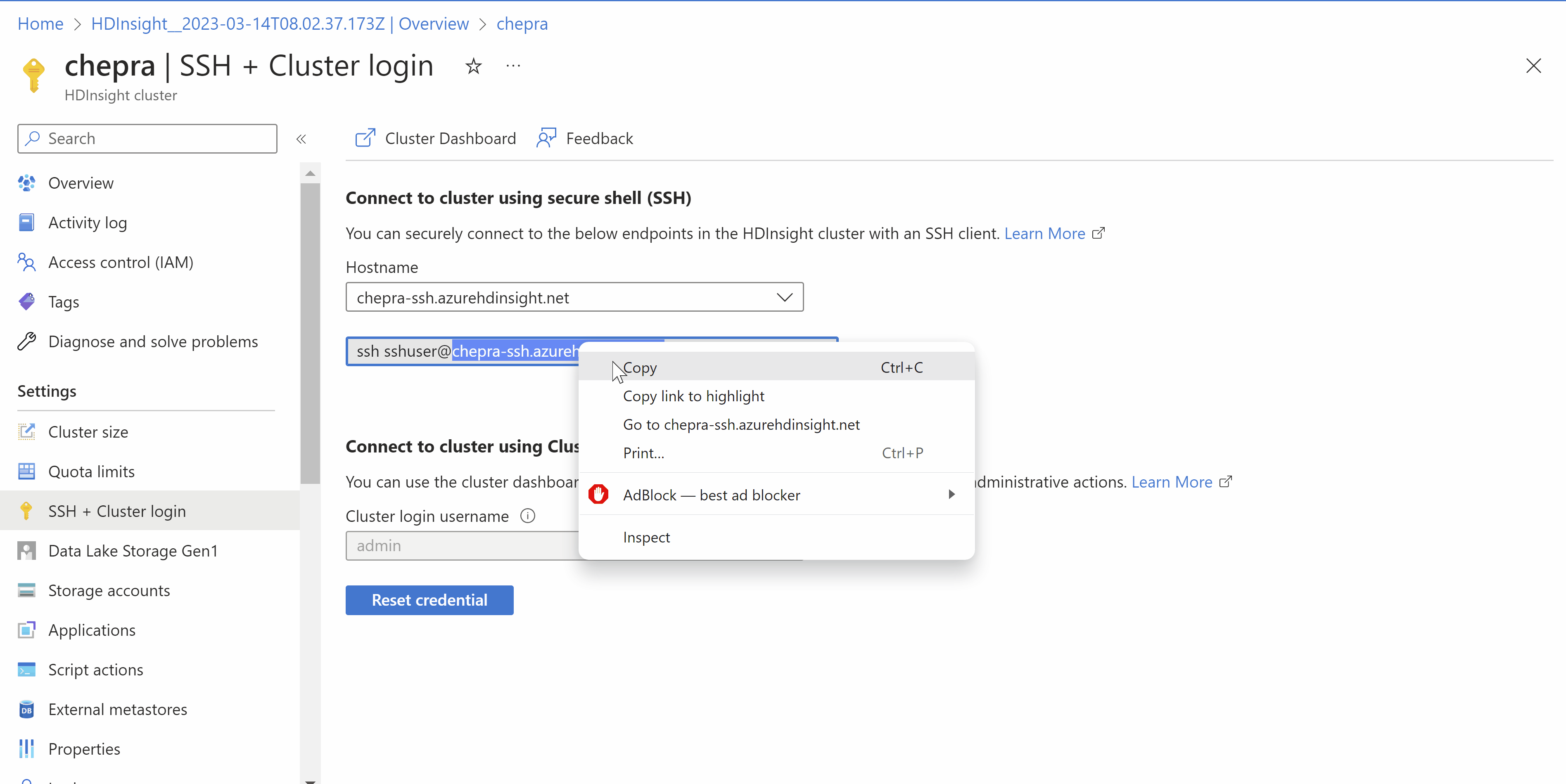

    Step2: SSH into HDInsight cluster and get the fully qualified domain name of the primary headnode.

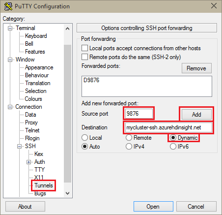

    Note: Options controlling SSH port forwarding enabled.
    PuTTY Configuration tunneling options
    Login using putty => ssh ******@CLUSTERNAME-ssh.azurehdinsight.net
    Once connected, use the following command to obtain the fully qualified domain name of the primary headnode: **hostname -f
    This will return a name similar to the following: hn0-myhdi-nfebtpfdv1nubcidphpap2eq2b.ex.internal.cloudapp.net
