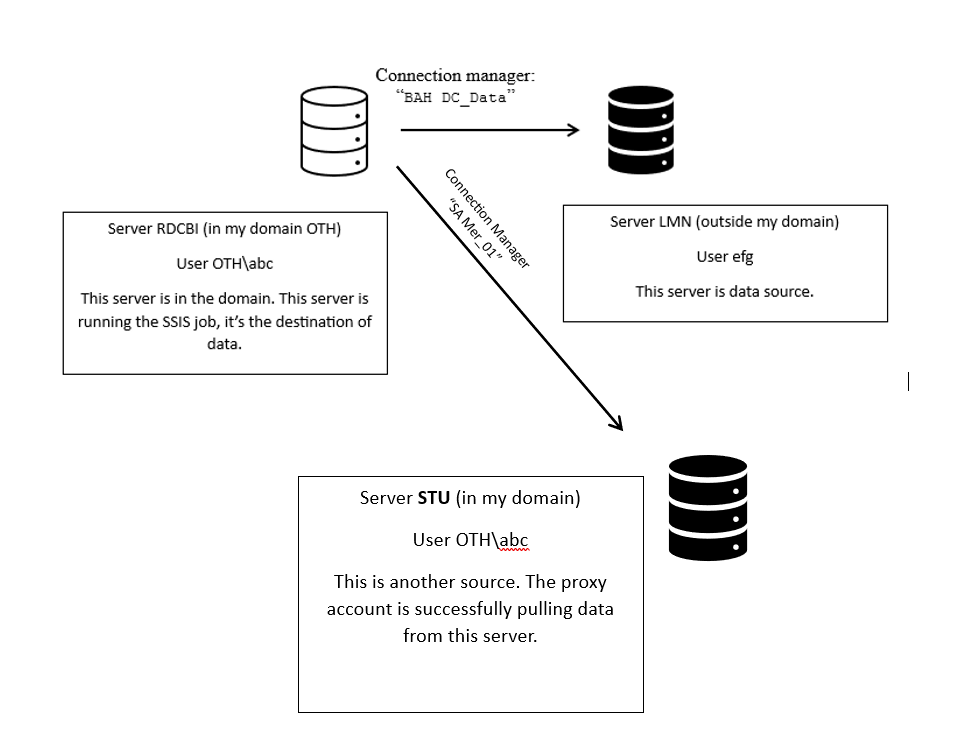

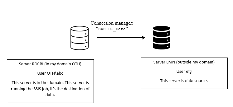

An ETL job schdule is failing to run. I am trying to bring data from server outside my domain. the admin on server LMN which is outside my domain created a login credentials (user efg)
when I run the job manually its successful. but on shcedule, it fails. here is the error I am getting.
Message Executed as user: OTH\abc. Microsoft (R) SQL Server Execute Package Utility Version 13.0.1601.5 for 64-bit Copyright (C) 2016 Microsoft. All rights reserved. Started: 4:40:01 PM Error: 2023-03-13 16:40:02.56 Code: 0xC0202009 Source: FECLoad Connection manager "BAH DC_Data" Description: SSIS Error Code DTS_E_OLEDBERROR. An OLE DB error has occurred. Error code: 0x80040E4D. An OLE DB record is available. Source: "Microsoft SQL Server Native Client 11.0" Hresult: 0x80040E4D Description: "Login failed for user 'efg'.". End Error Error: 2023-03-13 16:40:02.57 Code: 0xC020801C Source: Load FEC BAH to STG FEC BAH DC_Location_Info [2] Description: SSIS Error Code DTS_E_CANNOTACQUIRECONNECTIONFROMCONNECTIONMANAGER. The AcquireConnection method call to the connection manager "BAH DC_Data" failed with error code 0xC0202009. There may be error messages posted before this with more information on why the AcquireConnection method call failed. End Error Error: 2023-03-13 16:40:02.57 Code: 0xC0047017 Source: Load FEC BAH to STG SSIS.Pipeline Description: FEC BAH DC_Location_Info failed validation and returned error code 0xC020801C. End Error Error: 2023-03-13 16:40:02.57 Code: 0xC004700C Source: Load FEC BAH to STG SSIS.Pipeline Description: One or more component failed validation. End Error Error: 2023-03-13 16:40:02.57 Code: 0xC0024107 Source: Load FEC BAH to STG Description: There were errors during task validation. End Error DTExec: The package execution returned DTSER_FAILURE (1). Started: 4:40:01 PM Finished: 4:40:02 PM Elapsed: 1.422 seconds. The package execution failed. The step failed.

  3. Mohammed Abdul Majeed Khan 46 Reputation points
    2023-04-09T08:14:06.9333333+00:00
    Hi @ZoeHui-MSFT I made a proxy account and followed all the steps in your suggested blog but still job fails. The error is the following::
    Message Unable to start execution of step 1 (reason: Could not get proxy data for proxy_id = 4). The step failed.
