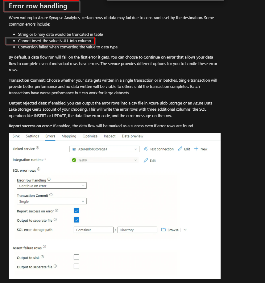

    You may also try exploring below error row handling mechanism and implement in your data flow settings to overcome the problem:
    Ref doc: Error row handling
