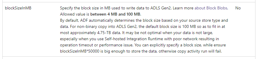

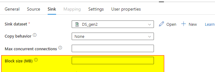

    Here are a few things you can try to improve the performance of your copy activity:
    • Increase the number of concurrent copy threads in ADF. This can be done in the "Settings" tab of the copy activity. Try to increase the number of threads to see if that improves performance.
    • When using"Binary" option, it skips metadata validation and can improve performance.
    • With a different Azure region for your ADF instance. If your ADF instance is in a different region than your storage account, this can cause slower copy times due to network latency.
