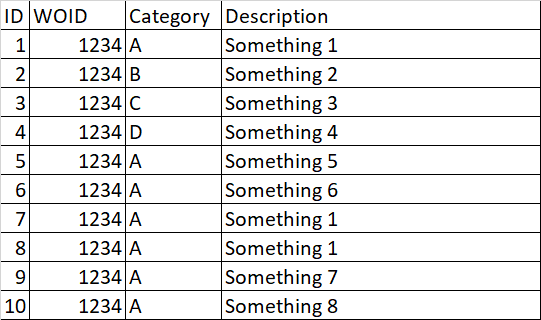

I have below data
I want to concatenate the row text into a string.

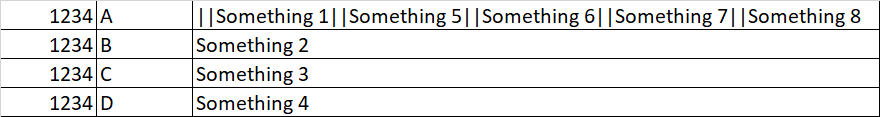

The expected out put is as below. Please note there are duplicate description for the same category.
The end result should remove the duplicate and concatenate the rows to string as below.

    Please don't give us your sample data as a picture. Instead, give us the CREATE TABLE or DECLARE TABLE and INSERT statements to give us the data (like, for example, I do below). Showing the desired output as a picture is fine.
    Also, I was not sure whether you really wanted a leading ||, but only when there were multiple Description or whether that was a mistake and you didn't want the leading ||. So I did it both ways.
