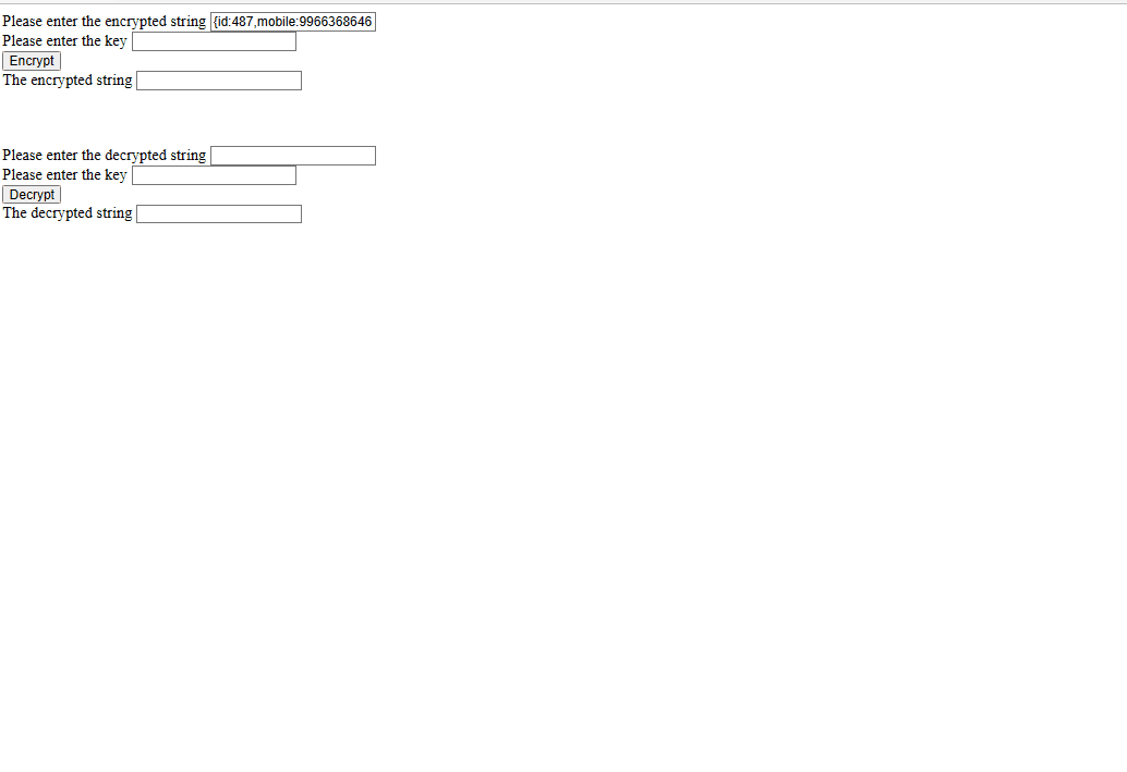

    </body>
    KEY_64 is Key. We use this key every time we encrypt and decrypt.
    It is mainly implemented using the DESCryptoServiceProvider class.
    You can learn more form this document.
    Output:
    Test6
    Best regards,
    Qi You
