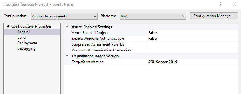

  2. ZoeHui-MSFT 41,551 Reputation points
    2023-03-17T02:11:22.04+00:00
    Hi @William Zorn
    Have you checked the Target Server Version? Make sure it matches with your deployed server version.
    Regards,
    Zoe Hui
