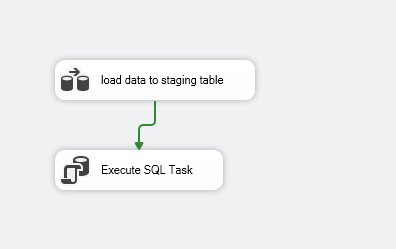

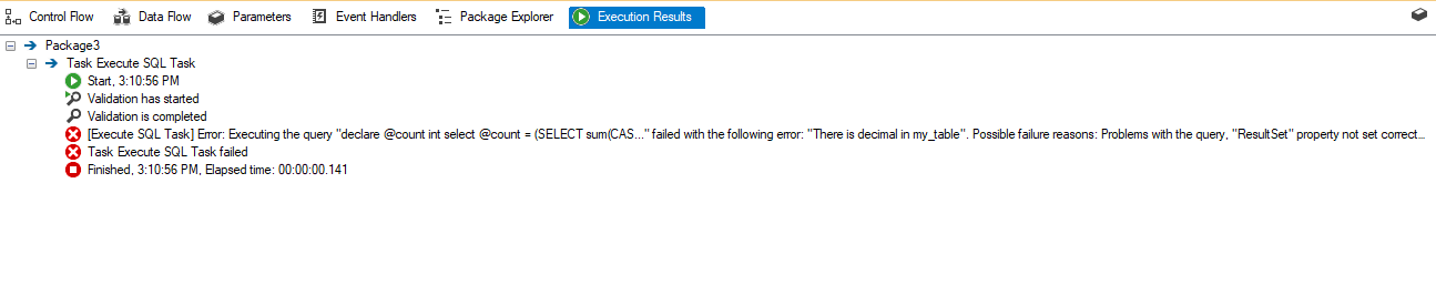

  1. ZoeHui-MSFT 41,491 Reputation points
    2023-03-17T07:13:47.4933333+00:00
    Hi @kkran
    You may use Execute SQL Task to do that.
    Step1: Create a staging table first in your database with below code. And then load the csv file data to the staging table first.
     CREATE TABLE staging table ([Part_Number] [varchar](50) NULL,
    	[Org_Name] [varchar](500) NULL,
    	[Month1] VARCHAR(MAX) NULL,
    	[Month2] VARCHAR(MAX) NULL,
    	[Month3] VARCHAR(MAX) NULL,
    	[Month4] VARCHAR(MAX) NULL)
    Step2: Add the Execute SQL Task with below command.
    declare @count int
    select @count = (SELECT sum(CASE WHEN CHARINDEX('.',[Month1],0) > 0 THEN 1
                                 WHEN CHARINDEX('.',[Month3],0) > 0 THEN 1
    							 WHEN CHARINDEX('.',[Month2],0) > 0 THEN 1
    							 WHEN CHARINDEX('.',[Month4],0) > 0 THEN 1 ELSE 0
    								END)
    FROM
    staging table)
    if @count >0
    begin
        raiserror('There is decimal in my_table',16,1)
    end
    else
    begin
     INSERT INTO TABLEA SELECT * FROM staging table
    end
    And then it will throw error/fail the process if there is a decimal value in the file.
