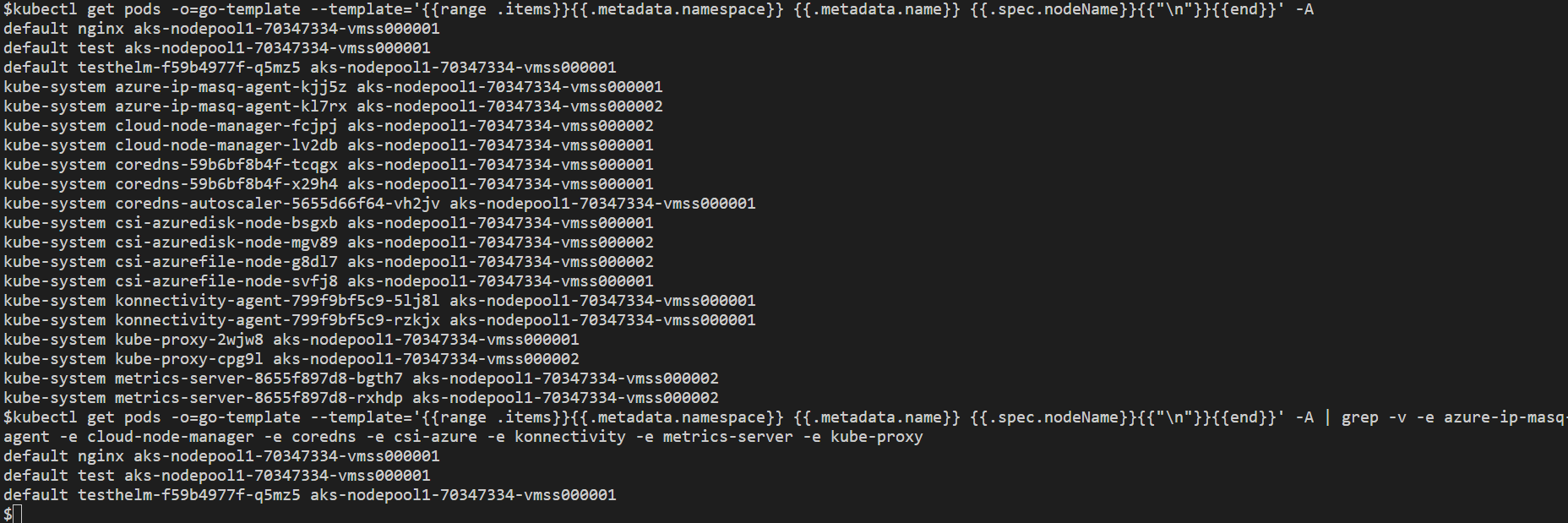

For example, the following command will display the namespace, pod name and the name of the node where the pod is scheduled in all namespaces:
kubectl get pods -o=go-template --template='{{range .items}}{{.metadata.namespace}} {{.metadata.name}} {{.spec.nodeName}}{{"\n"}}{{end}}' -A
Then you can exclude system pods like azure-ip-masq-agent, cloud-node-manager and so on with the following command in order to find the nodes that you need and remove the others. Please note that you may need to exclude other pods than I added in the command depending on your configuration.
kubectl get pods -o=go-template --template='{{range .items}}{{.metadata.namespace}} {{.metadata.name}} {{.spec.nodeName}}{{"\n"}}{{end}}' -A | grep -v -e azure-ip-masq-agent -e cloud-node-manager -e coredns -e csi-azure -e konnectivity -e metrics-server -e kube-proxy
For example on my side, I found that aks-nodepool1-70347334-vmss000001 is hosting application pods and that aks-nodepool1-70347334-vmss000001 is hosting only system pods, so I can remove aks-nodepool1-70347334-vmss000001.
