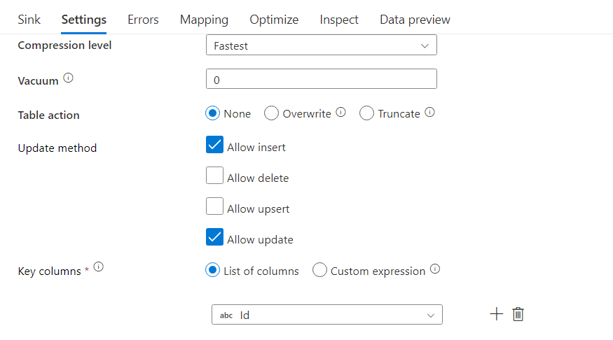

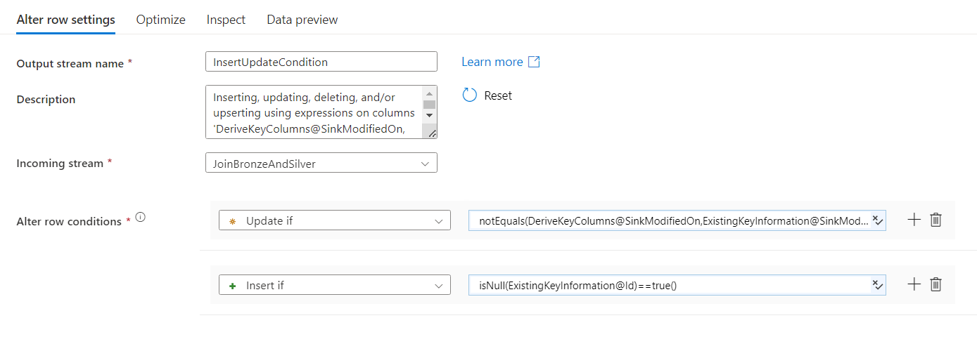

A dataflow mapping in Synapse writing to a delta sink should update rows based on an Alter row transformation. In the data preview of the debug session I can see that the row should be updated, however after running the pipeline the record is not being updated in the Delta lake.

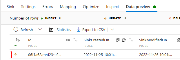

This is the data preview of the sink in data flow.
Does anyone know how to solve this?

    @JaneTeo-1997 What if you enable upsert?
    Also, you can find more diagnostic information if you go to monitoring tab, find the pipeline run, go into it and get the dataflow run details like rows affected.
