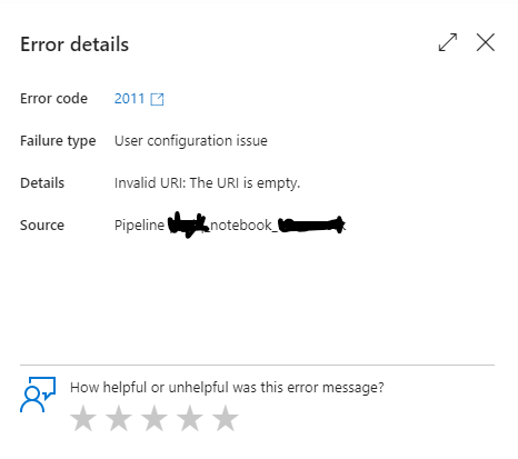

We are getting user configuration issues error code 2011 and invalid URI and the URI is empty

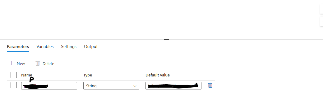

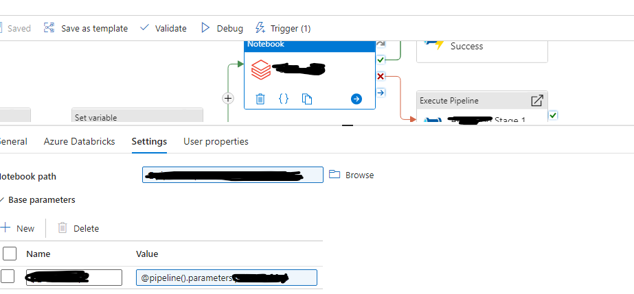

kindly find attached screenshot and help me same. I am passing pipeline parameters to get value in data bricks notebook base parameter to passing value to inside the notebook. this is which I am doing now.

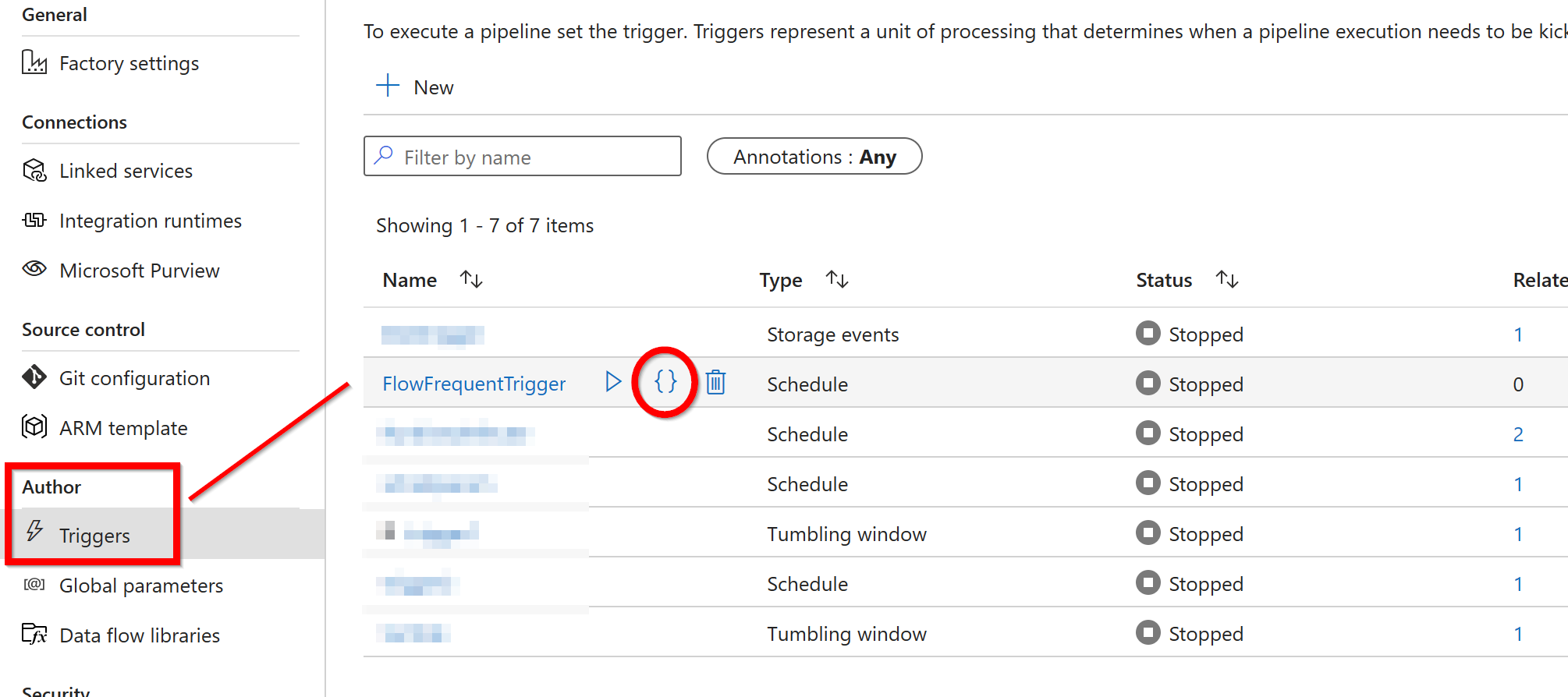

    Find the trigger definition under "Manage" > "Triggers" > {}
    In the trigger definition, look for "pipelines". This is the list of pipelines the trigger is used by. Find your pipeline by its "referenceName". Check for "parameters", as this details the parameter name & value. I suspect this is where the problem lies.

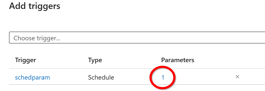

    You can also get this info from the Pipeline authoring screen by "Trigger" > "New / Edit" > my trigger > number of parameters.

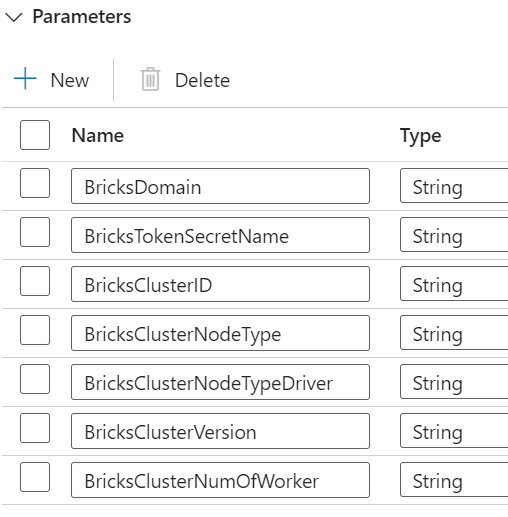

    I think this might be related to having a deployment parameter. When you publish to elevated environments, if you don't specify that the cluster or Databricks workspace id should inherit the default value specified in your code, this will be null, hence uri is coming through as empty.
    When you add new parameters to your arm template parameters json, make sure to put "=" instead of "-". The equals sign will persist the parameter through as a default unless you override it during deployment.
    Or just add this value to the parameters you pass in with the template file during deployment.
