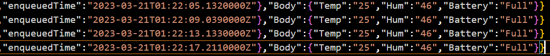

    Please note to replace the Topic with the appropriate device to which you would like to send the data. Once you set the parameters, you can view the message in the correct format. Please refer the below image for reference.
    Here is the documentation on MQTT provided on IoT Hub that provides this explanation https://learn.microsoft.com/en-us/azure/iot-hub/iot-hub-mqtt-support#sending-device-to-cloud-messages
    Kindly note that, the message format you see when you monitor the built in event end point in Azure cloud shell is not accurate depiction of the data received by the IoT Hub. If you route the data to blob container, you would see the message would still be in base64 format.
