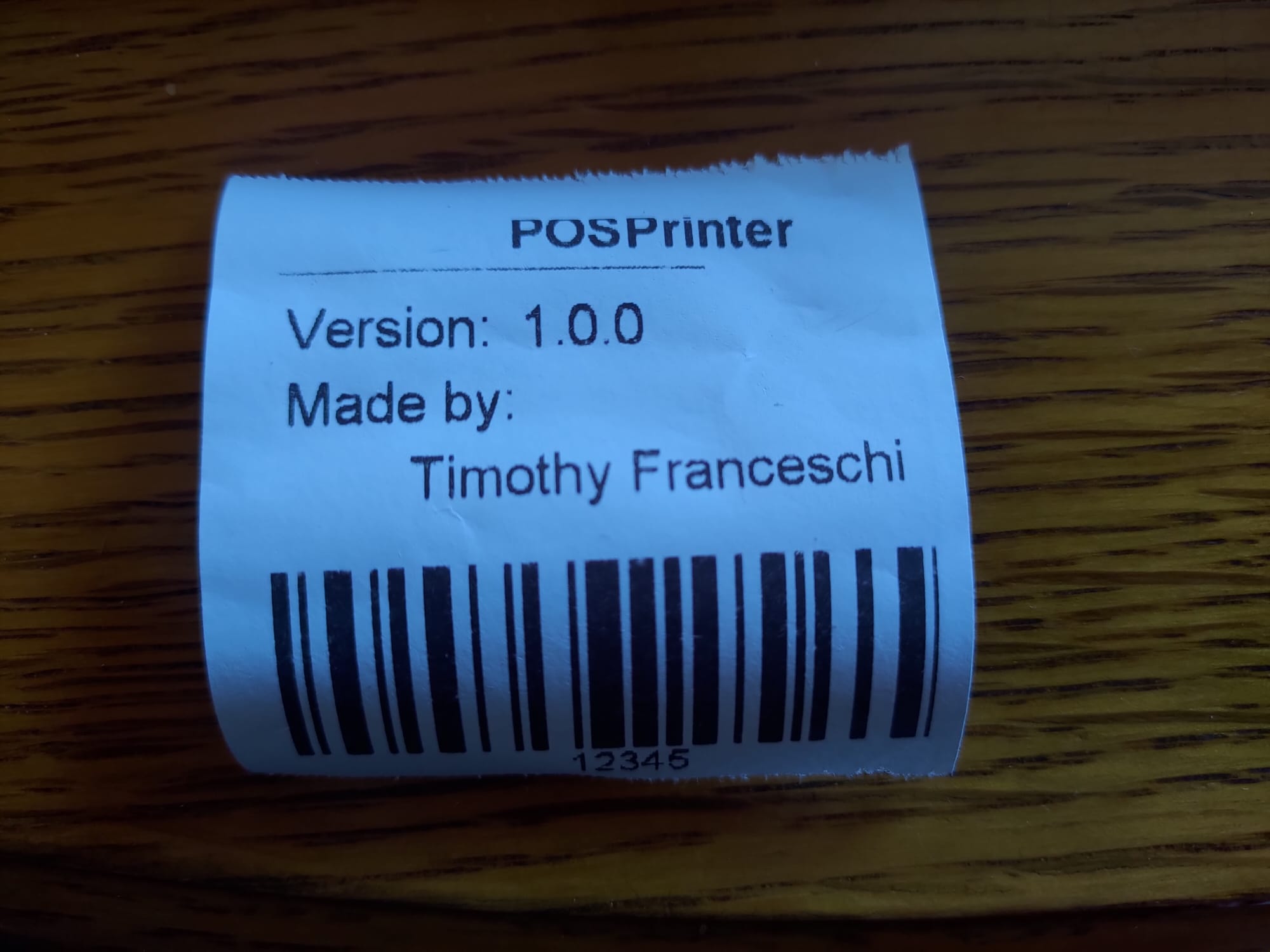

When aligned on the Left the text is good. But if I try to align on center or right then the text is not correctly aligned. I leave a photo to explain better:
image pos printer result
"POSPrinter" and "Timothy Franceschi" should be centered.

  2. Timothy Franceschi 0 Reputation points
    2023-03-20T18:09:27.9566667+00:00
    Don't know why. But this solved the problem:
    Public Sub PrintHLine()
            Dim myPen As New Pen(Color.Black)
            Dim startPoint As New PointF(0, myPoint.Y)
            Dim endPoint As New PointF(e.MarginBounds.Right, myPoint.Y)
            e.Graphics.DrawLine(myPen, startPoint, endPoint)
            myPoint = New PointF(0, myPoint.Y + (lineHeight * 0.8))
        End Sub
        Private Function CenterPosition(testo As String) As PointF
            'Calcola dimensioni testo
            Dim textSize As SizeF = e.Graphics.MeasureString(testo, myFont)
            Dim freeSpace As Single = e.PageSettings.PaperSize.Width - textSize.Width
            'Calcola coordinata X del testo
            Dim centerX As Single = ((e.PageSettings.PaperSize.Width - textSize.Width) / 2) - (e.PageSettings.Margins.Left / 2)
            Return New PointF(centerX, myPoint.Y)
        End Function
        Private Function RightPosition(testo As String) As PointF
        End Function
