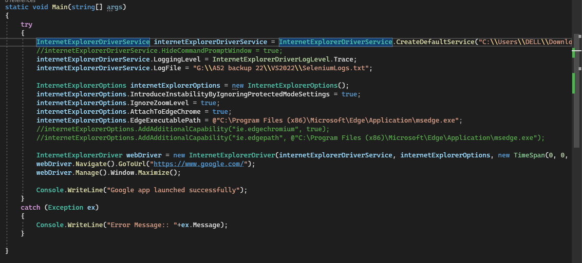

I was trying to automate Edge in IE mode using selenium IEDriverServer.exe. When the code is executed, the browser window appears on the screen and remains stuck for sometime giving a timeout exception. On debugging the code, this timeout exception is thrown while initilaizing InternetExplorerDriver object.
Automation Approach:
Using the code sample available on Microsoft website. All the pre-requsites mentioned on Selenium website are met.
https://learn.microsoft.com/en-us/microsoft-edge/webdriver-chromium/ie-mode?tabs=c-sharp
Observation:
Same code, when executed after adding the application URL in the Trusted Sites, is working.

    Hi @Simulator World
    I saw you asked the same question on StackOverflow. I'll follow up on this site.
    I see that you use InternetExplorerOptions.AddAdditionalCapability so I guess you use Selenium WebDriver 3. Selenium WebDriver 3 is deprecated now, and you need to upgrade to the latest version Selenium WebDriver 4.8.1. Besides, you need to place the IEDriver in your PATH.
    I test with Selenium WebDriver 4.8.1, IEDriver 4.8.1.0, Edge version 111.0.1661.44 on Win 11 with the sample code, it works well. You can have a try.
    Edit:
    You must set the Protected Mode settings for each zone to be the same value to meet the Required Configuration.
