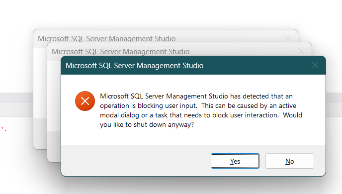

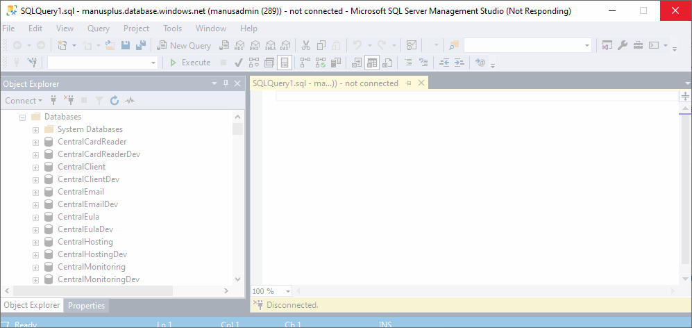

Hello there,
There is an annoying bug in the SSMS UI that I thought will be found and fixed with the latest version (19.0.1) I just installed. It persists in all the previous versions I used and is available here too.
Here is the description:
  1. Connect to (LocalDB)\XXX SQL server, open a new query type "SELECT GETDATE()" and execute it.
  2. Connect to another SQL server ( i tested it with Azure one), open a new query type "SELECT GETDATE()" and execute it.
  3. try to change current Database by putting in the field (on the left of the Execute button) non-existing DB name ( I usually do this by miss-typing a correct name) and press enter.
  4. SSMS hangs up and shows "Not responding" no matter how much time you give it to just show error and returns control to you.
After this the only way to use SSMS again is to kill it and start it anew.
Hope you'll find the problem and fix it soon.

    I am still seeing this issue when connecting to Azure SQL server. If I type in a database name that is either invalid, or do not have access to based on the currently logged in user, it hangs indefinitely after being unable to establish the connection.
    I am using SSMS 20:
    SQL Server Management Studio 20.0.70.0
