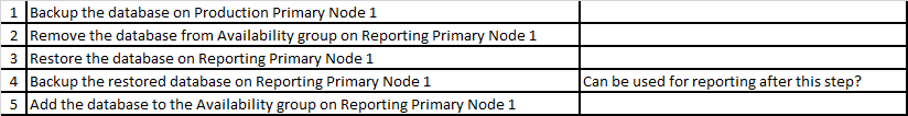

    @Bjoern Peters Are these the correct steps?

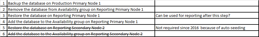

    @Bjoern Peters Yes, we are on same release level and it is SQL 2019. Here is the updated sequence:
