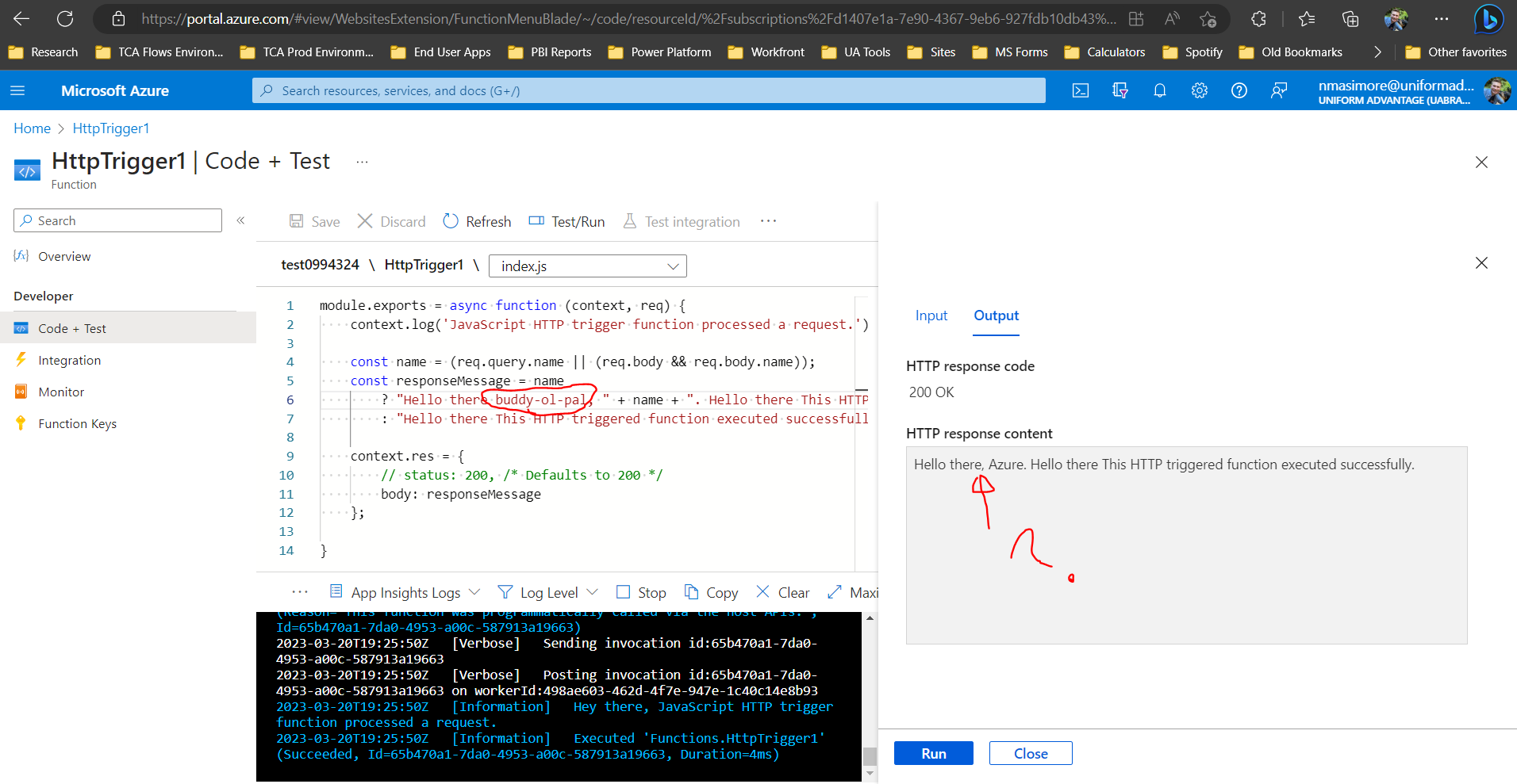

The weird thing is, I waited a day, and tried it the next day without changing anything. And it worked! So then I tried changing the code even more to say "buddy-ol-pal" instead of "buddy"... but it didn't work.
Any feedback here is appreciated, thank you!!! Below is a screenshot of what I'm seeing on my computer. Where the question mark is, it should say "buddy-ol-pal". I clicked Save, and then the "Refresh" button (next to "Discard" button) before running.

    The edits you've made in the code were simple string changes and because Javascript is an interpreted language that does not require a compilation process, you should have seen your changes reflected in a matter of less than a minute (or two at max) from hitting Save to hitting Run in the Test/Run blade. As such, the delay that you've observed was not of your doing in any way but possibly an abrupt networking (or browser) issue or a service up-time issue at Azure's end. I hope this doesn't keep you from continuing to play with Functions and the learning journey that you've ventured upon.
