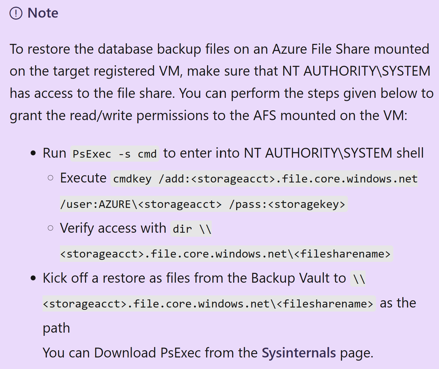

  • Run PsExec -s cmd to enter into NT AUTHORITY\SYSTEM shell
    • Execute cmdkey /add:<storageacct>.file.core.windows.net /user:AZURE\<storageacct> /pass:<storagekey>
    • Verify access with dir \\<storageacct>.file.core.windows.net\<filesharename>
  • Kick off a restore as files from the Backup Vault to \\<storageacct>.file.core.windows.net\<filesharename> as the path

  1. SadiqhAhmed-MSFT 49,326 Reputation points Microsoft Employee Moderator
    2023-03-21T13:01:21.3+00:00
    Hi @Mohamed jihad bayali Thank you for reaching out to us on Microsoft Q&A platform. Happy to help! I understand that you are trying to perform restore as files and it seems to be blocking with permissions issue. Did you follow the recommended steps from the link - I [understand that you are trying to perform restore as files and it seems to be blocking with permissions issue. Did you follow the recommended steps from the link - https://aka.ms/AA9opcktps://aka.ms/AA9opck User's image
    ](https://aka.ms/AA9opck)
    If yes, I would suggest you to confirm if there are restore points exist. If there is no backup, no restore is possible. Meaning, if restore point does not exist, you cannot perform the restore operation.
