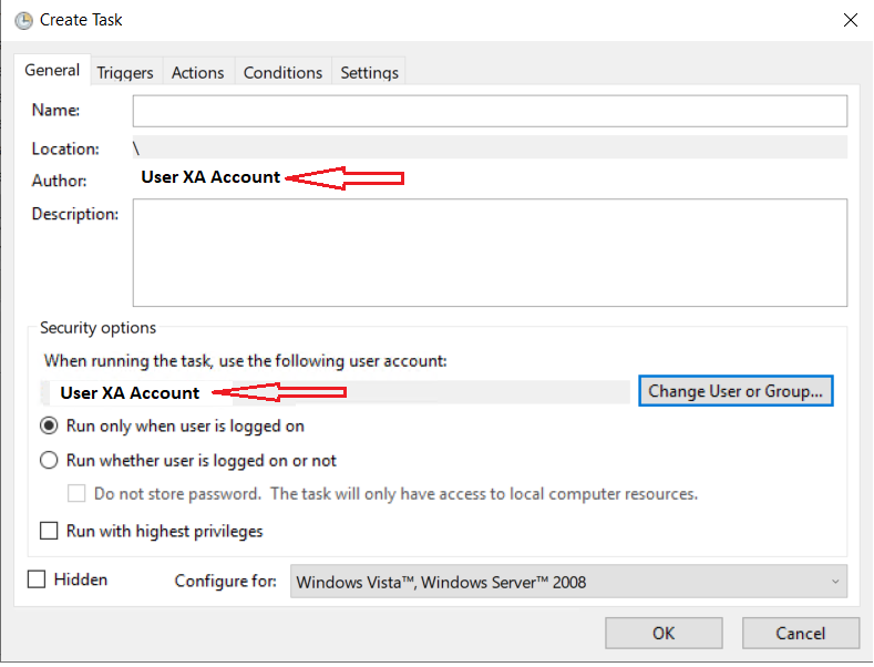

For this, i am logging in server using Admin Account and then configure the scheduling the task using service account.
I am facing the problem below.
  1. Whenever the admin account password getting expired, my task scheduler will stop or getting error due admin password expired.
  2. If i use both are Service Account (Logging the server and scheduling the task, then it will work fine) - But, this is not advisable. Because, Service account password is Static and it may hack/share the credentials to anyone.

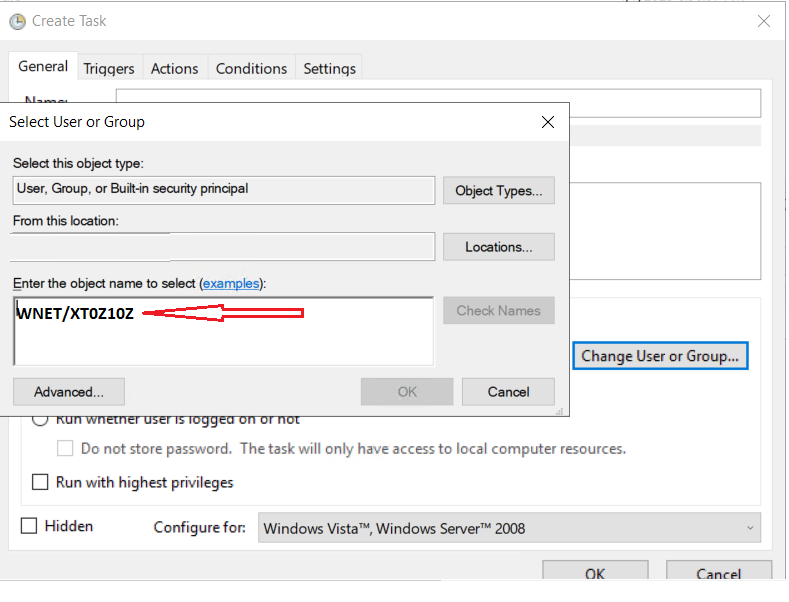

  3. I want the solution like below.
      I am always should logging using Admin account, and configure the task scheduler should use Service Account.
Is it possible to do the above...?
Or what is the alternative solution to run the task using service account.

  1. Ben Miller (DBAduck) 966 Reputation points
    2023-03-22T03:01:42.6066667+00:00
    Did you create the Task using the Run As account in the task itself? You have the option to use that mechanism in all Tasks.
  2. Ben Miller (DBAduck) 966 Reputation points
    2023-03-22T03:06:37.22+00:00
    You can use the Run As account in the task. Set that to the Service Account and Password.
