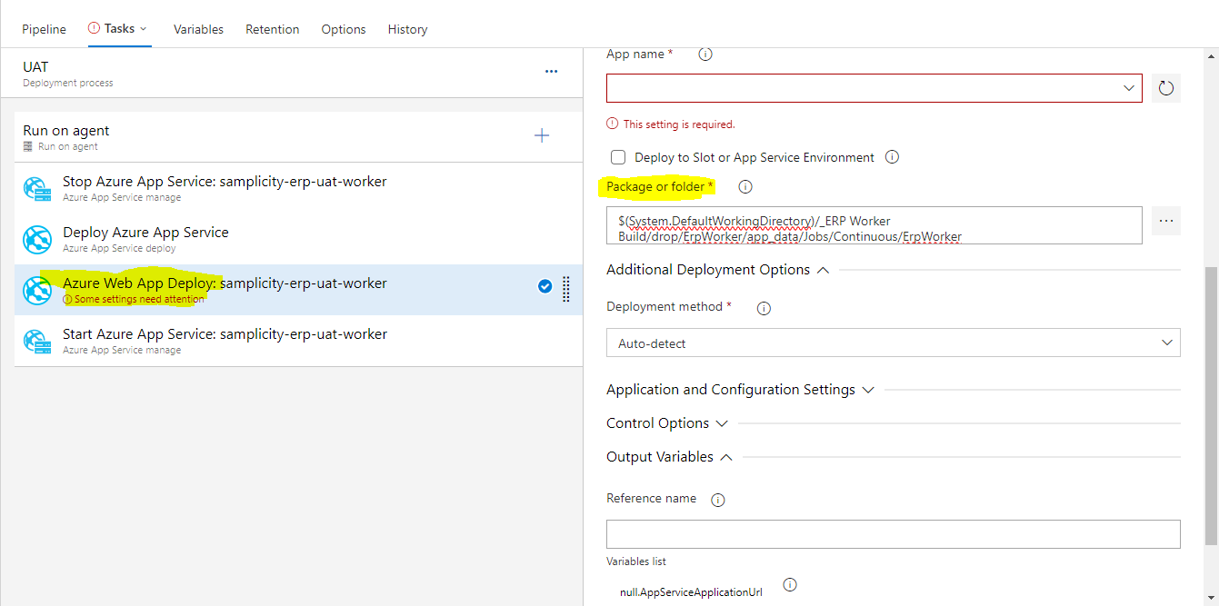

How can we configure CI/CD Pipelines for an azure Webjob of azure app service in azure DevOps.

  1. brtrach-MSFT 17,741 Reputation points Microsoft Employee Moderator
    2023-03-23T01:44:53.3366667+00:00
    To configure CI/CD pipelines for an Azure WebJob of Azure App Service in Azure DevOps, you can follow the steps below:
    1. Create a new pipeline in Azure DevOps and select the appropriate repository where your code is stored.
    2. Add a build step to build your WebJob project.
    3. Add a publish step to publish the WebJob artifacts to a staging directory.
    4. Add a deploy step to deploy the WebJob artifacts to the Azure App Service.
    5. In the deploy step, select the WebJob type as "Continuous" and specify the WebJob name and file path.
    6. Finally, save and run the pipeline to deploy the WebJob to the Azure App Service.
    You can find more detailed information on how to configure CI/CD pipelines for Azure WebJobs in Azure DevOps in this document.
    Let me know if you have any further questions or need more information.
