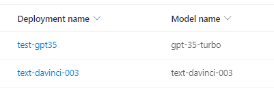

  5. YutongTie-9091 54,021 Reputation points Moderator
    2023-03-21T22:37:17.8366667+00:00
    Hello @Kyle Z
    Thanks for reaching out to us, I have read your code sample, I felt like there is something wrong about your code part - deployment_name='text-davinci-003'
    Are you sure 'text-davinci-003' is your deployment name? This name will correspond to the custom name you chose for your deployment when you deployed a model, not the model you are using. Please confirm this part.
    If you are sure about the name and your deployment has been there for more than one hour but you still get the error, please let us know, we can help you to raise a support ticket for this issue to check what's wrong with your deployment. Please let us know if you have no support plan in this situation, we are happy to help you enable a free ticket for this case.
