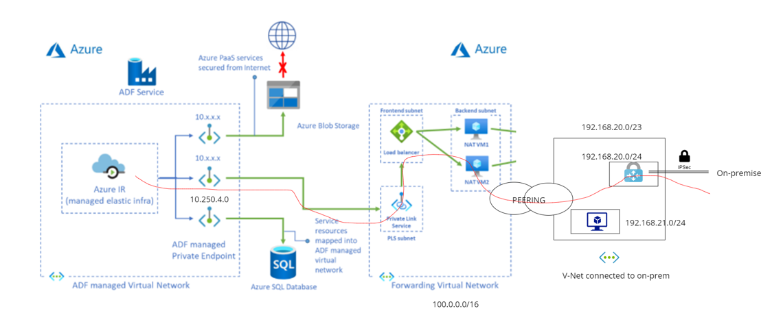

In this scenario, I created a V-Net as the tutorial says, but with an additional config. The forwarding is done to a peered network and that network has a VPN connected to on-prem. This is the architecture:

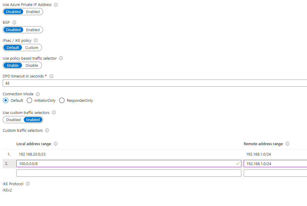

My problem is that from VMs placed in the net 192.168.21.0/24 I am able to connect to on-prem but the packages coming from Azure IR (10.250.4.0) are droped by the TS (Traffic selector) in VPN Gateway
I tried adding custom traffic selectors to the connection, but still not working. This is the configuration of the connection.
