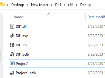

Can you help me figure out why the debugger will not load the pdb file?
It says it cannot find it but I know it is in the same directory. See attached image.
I don't know what I did to the project setting that caused this.
I started over with a new project file and was able to get it to work. But I cannot figure out what my existing project has that causes it to not load. The DLL compiles and works fine it just will not let me debug it.

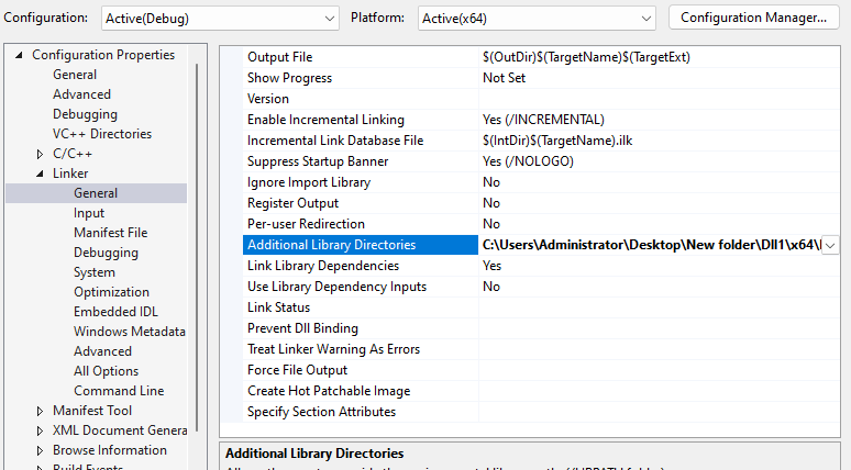

    I figured this out. For a DLL you must use the same directory for Output Directory and Intermediate directory:
    I made these the same and now it is working. (This is from Project Property file.)
      <PropertyGroup>
        <OutDir>$(SolutionDir)Build\$(Configuration)\$(ProjectName)\</OutDir>
        <IntDir>$(SolutionDir)Build\$(Configuration)\$(ProjectName)\</IntDir>
      </PropertyGroup>
    Also ending up have to make sure: (This is from Project Property file.)
          <ProgramDataBaseFileName>$(IntDir)vc$(PlatformToolsetVersion).pdb</ProgramDataBaseFileName>
    For the compile side.
    Link side is default as well.
    Compiler and Linker must have different names for "ProgramDataBaseFileName"
    I have not worked with DLL's as much. I have never had this problem before with static libraries are exe.
