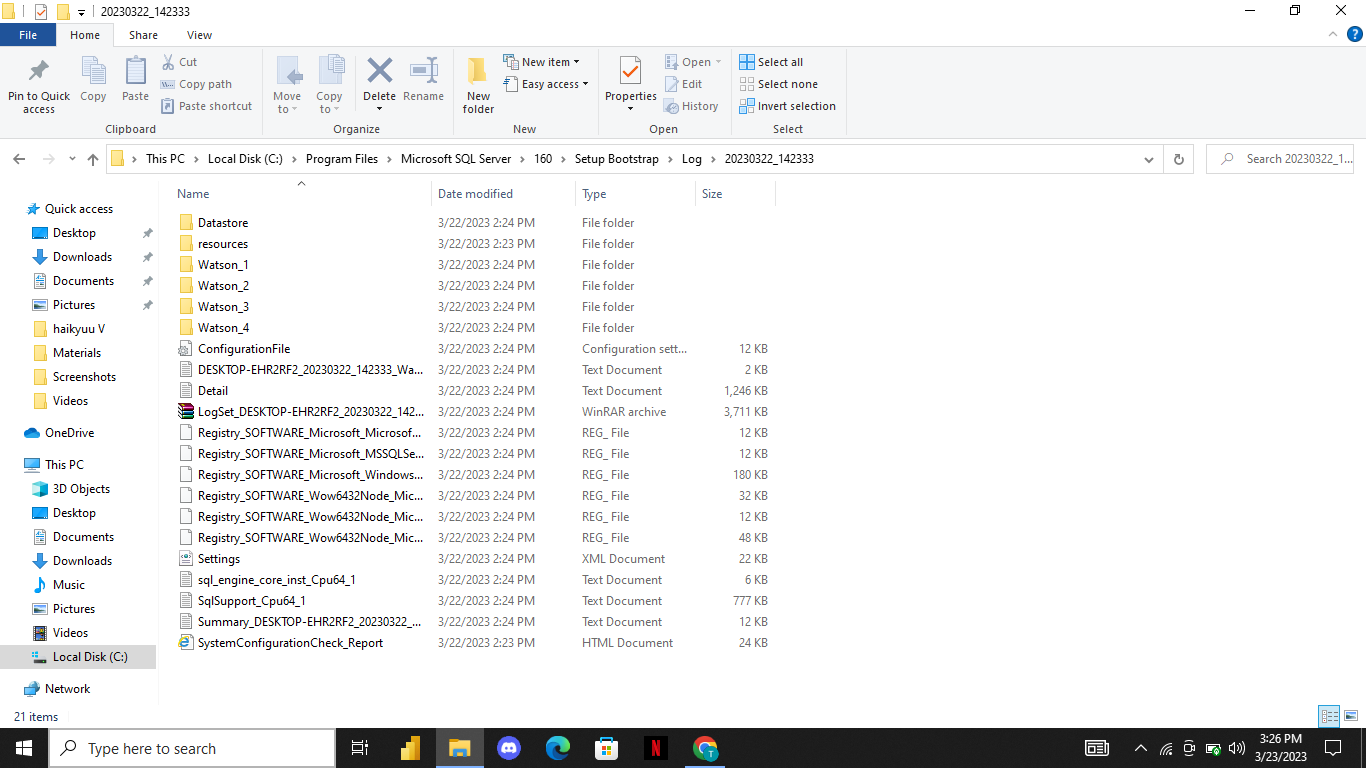

I keep getting this error every time I try to download the SQL server. Has anyone encountered this before, I would appreciate any help with this . Thank youScreenshot (2)

    There are several reasons for this installation error. Could you please post the error logs.
    The location by default is: C:\Program Files\Microsoft SQL Server\160\Setup Bootstrap\Log
    There is a summary.txt file and many subfolders created every time the Installation wizard is started. In those subfolders, we can also find a Detail.txt file.
