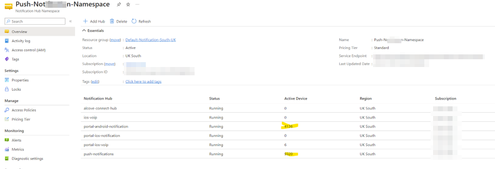

Hello,
When I try to register a new device I get 'The maximum number of devices has been reached or exceeded for the namespace.' error. I have a Basic subscription which allows 200K active users. When I check the Azure Portal I can see that I have 123K active registered users of the allowed 200K.
I don't understand what limit I exceeded. I am using this Notification Hub for several years and I didn't change anything recently.
Where can I check which limit I exceeded?
Thank you for the help in advance,
Henrik

  1. VenkateshDodda-MSFT 25,111 Reputation points Microsoft Employee Moderator
    2023-03-24T10:09:48.27+00:00
    @Henrik Barna Thanks for your patience on this. I have check with Notification Hub engineering team and they have confirmed that this was happened due to recent code regression.
    Engineer team has created a fix and deployed to all the regions as well. I would suggest you retry the operation registering a new device and do let us know if the issue still remains the same.
    Feel free to reach back to me if you have any further questions on this.
