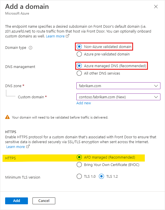

    Since you've mentioned "I added a custom domain and applied for a certificate", I believe you have enabled/configured HTTPS on your Azure Front Door custom domain.
    Could you please confirm this?

    AFD Classic: https://learn.microsoft.com/en-us/azure/frontdoor/front-door-custom-domain-https
    AFD Standard/Premium: https://learn.microsoft.com/en-us/azure/frontdoor/standard-premium/how-to-configure-https-custom-domain

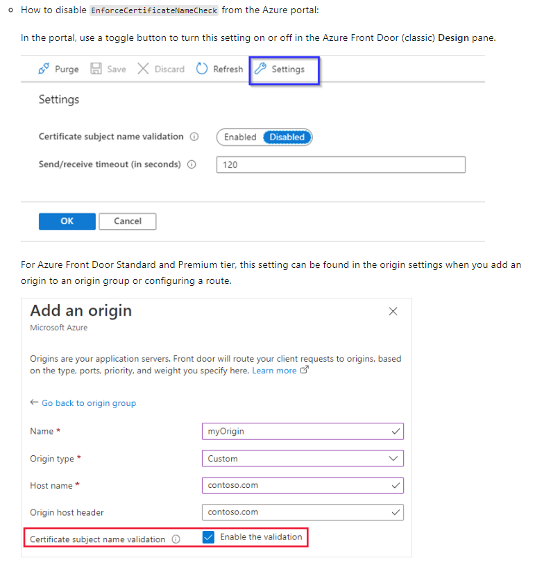

    503 error is returned if you connect to Azure Front Door HTTPS-enabled endpoints with IP based backend.
    Azure Front Door has a switch called EnforceCertificateNameCheck. By default, this setting is enabled. When enabled, Azure Front Door checks that the backend pool host name FQDN matches the backend server certificate's certificate name or one of the entries in the subject alternative names extension.
    However, as you are using IP address as the backend, your HTTPS-enabled Azure Front Door is failing the check.
    To resolve this issue, you must disable "EnforceCertificateNameCheck".
    Refer: https://learn.microsoft.com/en-us/azure/frontdoor/troubleshoot-issues#503-responses-from-azure-front-door-only-for-https
