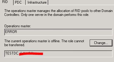

Hi, our environment has a DC and OS version is 2008R2, I created a new VM server and promote to DC, but this is very weird that both seem cannot connect, when one PC join the domain, only old DC (2008r2) can find its computer object, also, I tried to update the DNS record in new DC, the old DC doesn't sync anything, vice versa, but 5 roles PDC,RID and others are in new DC, how can I transfer the roles to old DC? Or any other alternative way to fix the problem? Here is the current Role state in old DC (2008R2)
testdc-error-2023-Mar-23

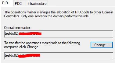

And in new DC, the same name and shown cannot transfer
testdc02-error-2023-Mar-23

  1. Limitless Technology 45,126 Reputation points
    2023-03-23T16:34:35.08+00:00
    Hello
    Thank you for your question and reaching out. I can understand you are having query\issues related to DC sync and transfer.
    It looks there is issues with AD replication health due to AD configuration are not synced.
    1. At the command prompt, type the following commands, and then press ENTER
    dcdiag /v /c /d /e /s: > c:\dcdiag.txt
    repadmin /replsum
    dcdiag /test:dns /s: /dnsbasic
    repadmin /syncall /aped
    1. Please verify DNS settings and its ip preferred DNS ip should be pointed to one of your working DC.
    2. Disable any Antivirus program or Windows firewall you may have for temporary purpose.
    3. Verify date and time should be correct and synced.
    4. Run Active Directory Replication Status tool to check overall health of AD Replication : from https://www.microsoft.com/en-us/download/details.aspx?id=30005
    Reference :
    https://learn.microsoft.com/en-us/windows-server/identity/ad-ds/manage/troubleshoot/troubleshooting-active-directory-replication-problems
    https://learn.microsoft.com/en-us/troubleshoot/windows-server/identity/common-active-directory-replication-errors
    --If the reply is helpful, please Upvote and Accept as answer--
