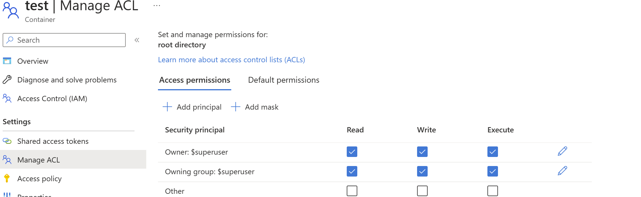

    I understand that in spite of giving the logic apps owner permission in the Storage account, you still cannot create blob using logic apps. Are you using Blob Storage or ADLS Gen2? If using ADLS Gen2, can you please confirm the container where you are creating Blob has write permissions as well as shown below-
    Please refer to Manage ACLs for ADLS Gen2- https://learn.microsoft.com/en-us/azure/storage/blobs/data-lake-storage-access-control
