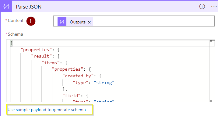

    Did you try Json Parser?
    Add a "parse JSON"
    Add the json output to the content (#1) field
    Click on "use sample payload to generate schema" and paste the json sample in there

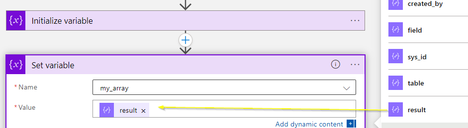

    Parse Json will create the array as you suggested above. after that depend on how you want to access it. to loop through it you can do like this:
    I used a set variable only to show that the array is under the "result" object coming from the "Parse Json"
    this is the history view:

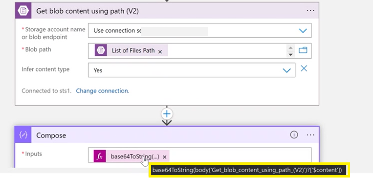

    @Biju Mathew Thanks for reaching out. As per the screenshot that you have shared, I can see the input is the octet stream, so you need to convert the convert the $content output of your blob connector to base64String in your ParseJSON action
    For your reference sharing the screenshot. Please update the action name as per your workflow.
    Feel free to get back to me if you need any assistance.

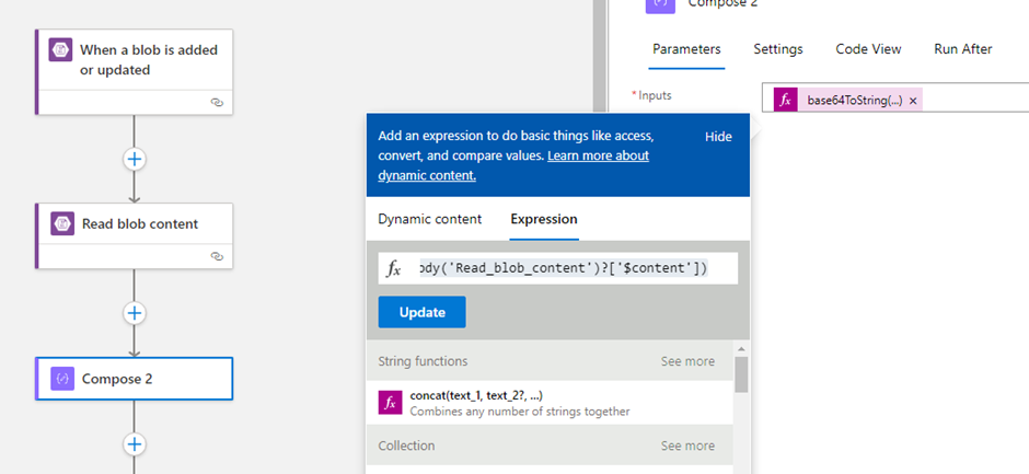

    Thanks @MayankBargali-MSFT , @Bruno Lucas for your continued assistance. Sorry about the delay in response.

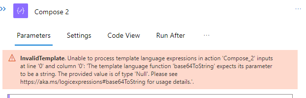

    I have tried the approaches you mentioned but i still get the issue. Please see below.
    This is how Compose 2 inputs property is configured
    base64ToString(body('Read_blob_content')?['$content'])
    Please I am not sure what else to try . I must point out that our Logic Apps instance is a Standard, App Service Environment model.
    Please any other tips to try.
