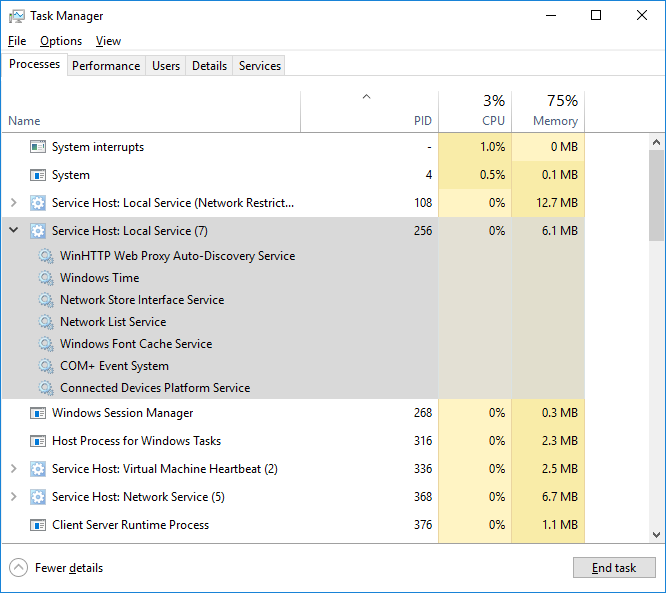

    So I'd do a
    netstat -aon>C:\netstat.txt
    then look for a line in the file similar to
      UDP    0.0.0.0:123            *:*                                    256
    then use Task Manager\Processes tab to see that the PID is for Windows Time service
    enter image description here
    then you can use prtqry tool to check from the 10 client.
    https://learn.microsoft.com/en-US/troubleshoot/windows-server/networking/portqry-command-line-port-scanner-v2#step-2-specialized-tests
