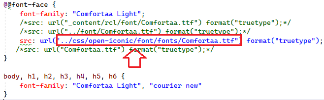

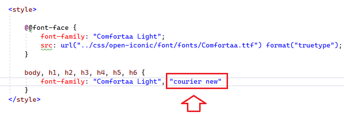

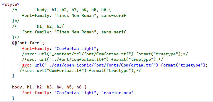

In the file index.html I loaded the font under <style>:

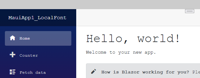

I also specified the alternative font "courier new". As you can see, it seems that the app cannot find my font and therefore uses "courier new".

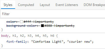

Checking App with F12 shows that right font is setting:

As you can see, I have tried pretty much all the variations, but nothing helps.

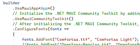

By the way, I also specified the font under MauiProgram.cs (although I don't think it has any effect on Blazor).

    Here too, if you change the alternative font and enter "courir new", for example, you will see that it is loaded.
    The customisation for font loading in the Github project is in the index.html file :

    It works now! It was actually due to my incorrect writing. It should have been:
            @font-face {
                font-family: "Comfortaa Light";
                /*src: url("_content/rcl/font/Comfortaa.ttf") format("truetype");*/
                /*src: url("../font/Comfortaa.ttf") format("truetype");*/
                /*src: url("../css/open-iconic/font/fonts/Comfortaa.ttf") format("truetype");*/
                src: url("./css/open-iconic/font/fonts/Comfortaa.ttf") format("truetype");
                /*src: url("Comfortaa.ttf") format("truetype");*/
