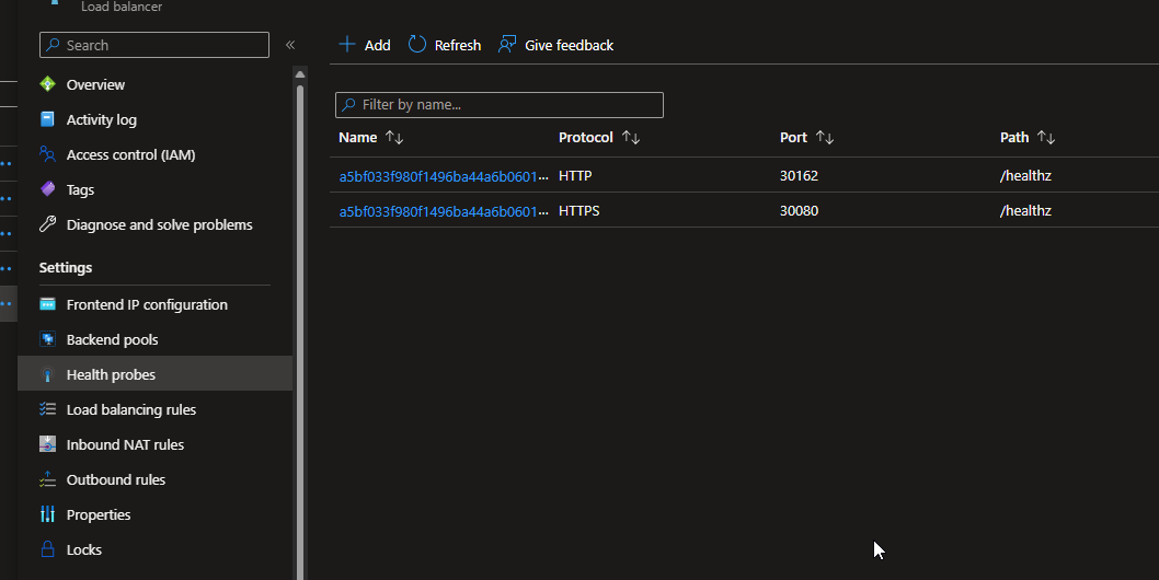

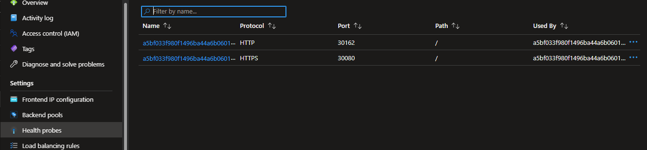

    You can also see this in the portal:
    Before:
    After:
