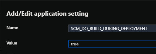

    Thanks for reaching here! It seems you are using Zip Deploy (with Oryx Builder).
    So, If you are doing a Zip Deploy, and need your packages to be installed by the remote builder, which is Oryx, the App Setting SCM_DO_BUILD_DURING_DEPLOYMENT set to true must be added.
    Oryx Buidler App Setting
    As called out in the documentation here - the Zip package is assumed to be ready to run as-is. Otherwise, if you are not including your node_modules in the Zip - and do not have SCM_DO_BUILD_DURING_DEPLOYMENT set to true, you will run into module not found errors.
    The resolution in these scenarios with Zip Deploy is to add the App Setting SCM_DO_BUILD_DURING_DEPLOYMENT to true and attempt a redeployment
    More information on this Zip Deployment process can be found here on the GitHub projectkudu repository.
    Please let us know if further query or issue remains.
  2. David He (AU) 15 Reputation points
    2023-08-23T09:48:26.0133333+00:00
    Hey Sneha
    I have exactly the same issue and added changes per your reply but it still doesn't work.
    See logs
