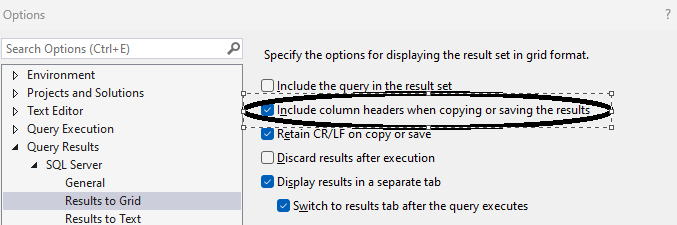

I just need to get my query results out to a CSV file WITH Headers quickly (without going through the whole SSIS process for a one-off job). I thought the option below would do the trick, but I get a CSV WITHOUT Headers. Advice?

    Hi @Dom
    Tools -> Options -> Query Results -> SQL Server -> Results to Grid -> Include columns headers when copying or saving the result.
    You might have to close and restart SSMS after changing this option.
    Then right click the grid result and select Save Result As...

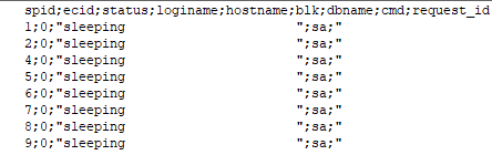

    And got this csv file:

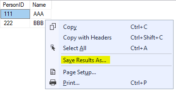

  1. Michael Taylor 61,116 Reputation points
    2023-03-28T21:38:26.3633333+00:00
    In SSMS? Run your query and get the results in the grid. Right click anywhere in the grid and select Save Results As. Enter the filename and click save. It exports to CSV with headers.
  2. Erland Sommarskog 129.6K Reputation points MVP Volunteer Moderator
    2023-03-28T21:53:59.6+00:00
    I tried the option you have in the picture, and I do get headers:
    Note that you need to open a new query window for the setting to take effect.
    And keep in mind that this is a fairly simple-minded option. You may note that in the above there are three commas per line, despite that there are only three header columns. This is because the values in the Amount column are being formatted to to my regional settings. But SSMS is not doing anything to save the situation. The same would be if there is comma in a string.
