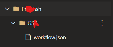

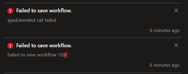

I have deployed my standard logic app workflow using azure DevOps
when i try to edit it from portal it gives following error

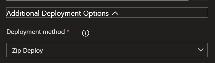

    @VenkateshDodda-MSFT Thank you for the free support. I got the solution. We need to remove WEBSITE_RUN_FROM_PACKAGE from the app setting and when we are deploying through DevOps, we need to choose zip deployment as the deployment method.
