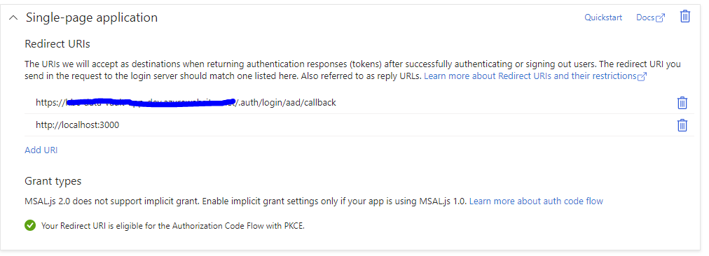

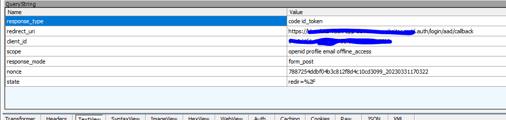

I am deploying a nextjs app to azure app service with msal-react for authentication. everything works fine locally and using localhost as redirect uri. when i deploy to my hosted app service on azure i can get it to work briefly, but then i always end up getting the error: AADSTS9002325: Proof Key for Code Exchange is required for cross-origin authorization code redemption. i have tried all combinations of redirect uri's but nothing has worked.

    The redirect_uri of the external sso / idp should be registered as a "Web" instead of SPA.
    I had the same issue with my project, my Azure AD tenant set up as an identity provider was giving me "AADSTS9002325: Proof Key for Code Exchange is required for cross-origin authorization code redemption error".
    https://learn.microsoft.com/en-us/azure/active-directory-b2c/identity-provider-azure-ad-single-tenant?pivots=b2c-user-flow
    I set it up based on this but had everything changed to SPA as I thought that was what was needed based on the SPA tutorials which i followed: https://learn.microsoft.com/en-us/azure/active-directory-b2c/configure-authentication-sample-react-spa-app
    I was at a lost and changed a lot of parameters, I tried changing everything to web but it caused some errors afterwards, it seems the best is to only change the auth resp to web. I don't exactly understand why either but it fixed the PKCE error without any of the other weirdness.

    Problem fixed by moving the callback url http://localhost:3000/api/auth/callback/azure-ad into the Web platform section In my case I got this error because I am using Next.js and with nextauth.js for Azure AD. Next.js and NextAuth utilize React server components which essentially is a classic 2-tier client/web-server architecture and the Oauth is carried out on the web server side. Moving the callback URL into the "Web Platform" section avoids the CORS error I got when my callback was full client side in the "Single Page App Platform" section. Without a deep dive, I speculate single page apps using the msal library conduct the Oauth choreography solely in the browser in javascript and CORS is handled differently
