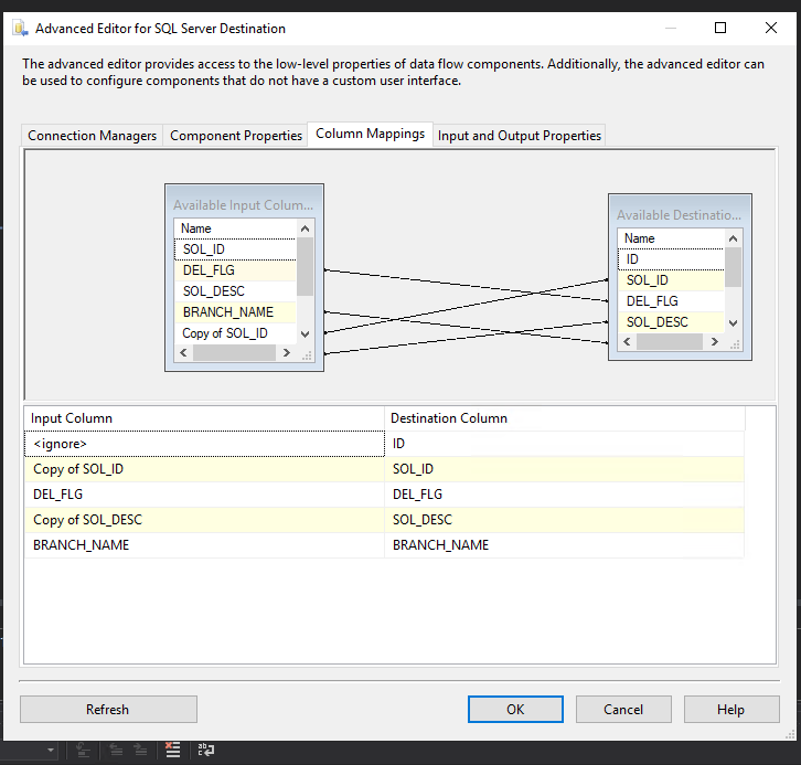

I have successful created both the ODBC and SSMS connection managers and can see data from the source and destination tables if I execute an SQL task directly to the DBs.
My challenge is that when I set up a data flow task with the following components, I encounter the errors below. Please how do I fix this error?

  1. ZoeHui-MSFT 41,466 Reputation points
    2023-03-31T05:33:00.8333333+00:00
    Hi @Jacinta Ejiofor ,
    Please have check that Run64bitruntime property and set it to false for a try.
    What's your version of the SQL Server?
    If you are using SQL Server 2019 CU1 and later, it is highly suggested that you may use Microsoft Connector for Oracle.
    he following Microsoft SQL Server products are supported by Microsoft Connector for Oracle:
    • Since SQL Server 2019 CU1
    • SQL Server Integration Services Projects for Visual Studio 2019
    Check: Microsoft Connector for Oracle
