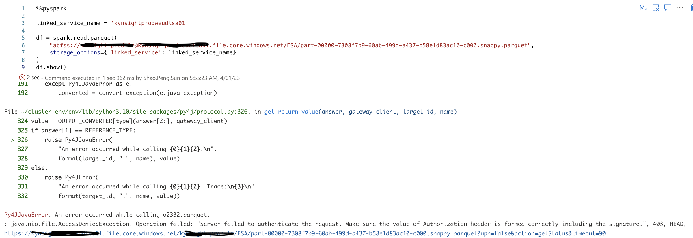

    Please see the below screenshot for your reference.
    Using this, I was able to read my parquet file.
    I hope this help.

  1. Sullivan Paul - Basel 15 Reputation points
    2023-05-23T18:02:42.9+00:00
    So we still have to use the storage account name. Which means, from the point of view of being able to deploy environment-aware linked services and use them from environment-unaware code, it's pointless.
