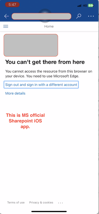

I have also noticed in Microsoft Official Sharepoint iOS application, they are still using the Webkit for loading the Sharepoint sites. when I logged in to the app on an unmanaged device I am getting the same problem in the Sharepoint app too. (screenshot attached) but when I tried on the managed device it was working and loading all the content in the Webkit browser.

Sharepoint app

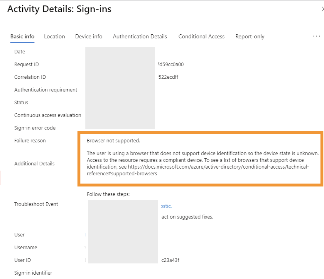

Below screenshot from Intune portal for the activity log details when we try to login in Webkit from our iOS app.
Screenshot 2023-03-31 at 2.40.03 PM

    Recently we've been getting complaints about failed from these mobile apps logins. I've had a case open with MSS for a couple weeks now. The mobile app calls a webview to handle the SSO authentication. The webview always appears to be Mobile Safari (default browser setting in the OS makes no difference). Mobile Safari is unable to pull any of the Intune device information (DeviceID) so the Conditional Access policy can't determine if the device is Complaint. The webview also isn't showing as the app that called it. So if I try to exclude one of the affected apps (say SFDC) from the CA policy, it still fails because the webview doesnt identify itself as SFDC.
