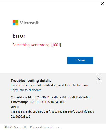

Users now receive an error 'OneDrive failed to sign in'. When clicking on the OneDrive Sync app to proceed with Sign in users are presented with the following error:
OneDrive Error 1001
OneDrive Error 0x8004e4be
I cannot find any resources related to the above two error codes/messages.

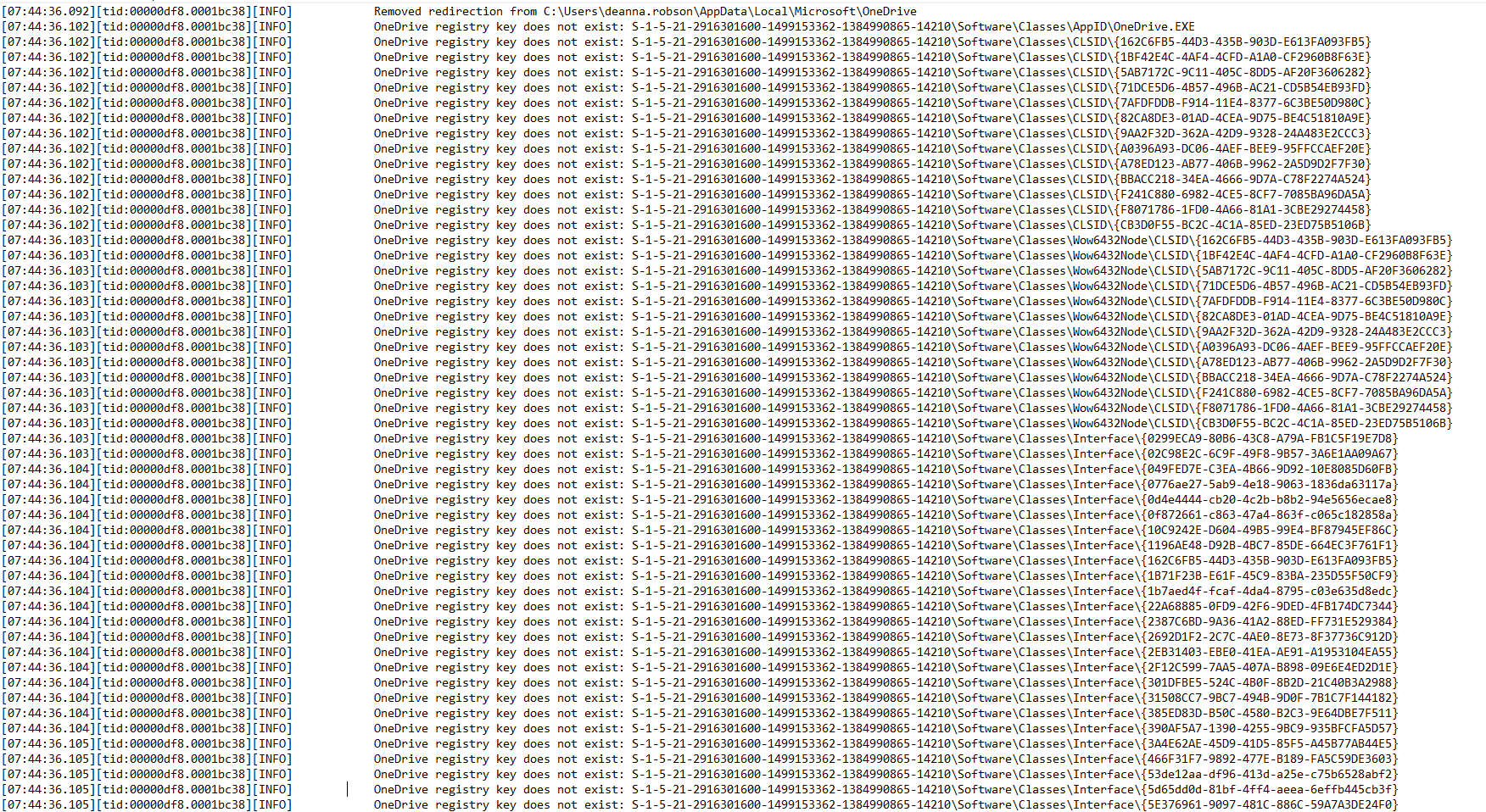

Upon investigating the FSLogix Logs, affected users have the following logs in the ODFC container:
OneDrive ODFC Registry Missing
