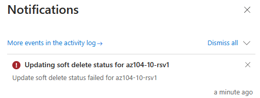

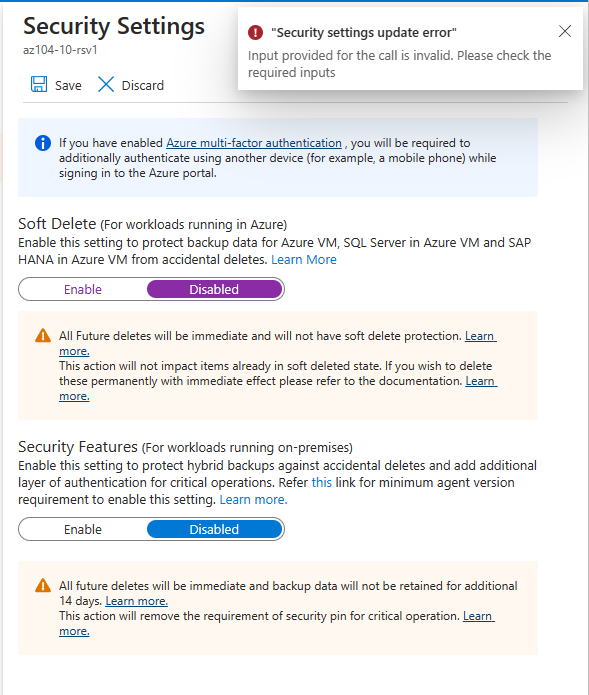

When I try to disable the soft delete for a recovery service vault to delete it I face the below error message.
I'm using an Azure Account with Owner Role over the Resource Group where I did put the RSV.
When I tried to disable the soft delete from RSV overview I face the below error:

    In your case it appears to be an issue within the azure side SDK causing the error "input provided for the call is invalid". My recommendation is to try from command line method like azure PowerShell as a quick workaround to get you unblocked from this situation.

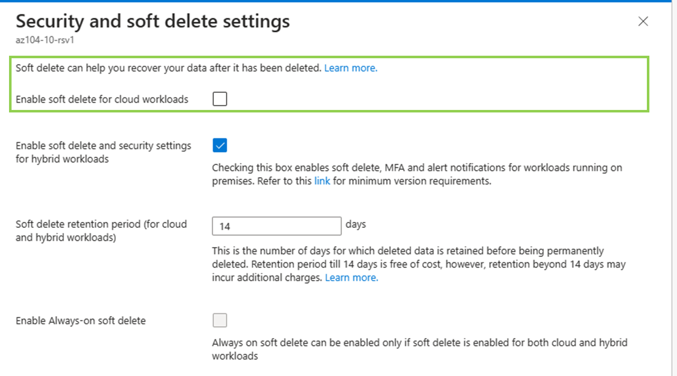

    After run the PS command suggested (Set-AzRecoveryServicesVaultProperty -VaultId $rsv1.id -SoftDeleteFeatureState Disable) I can disable the soft delete for cloud (see the below image) User's image

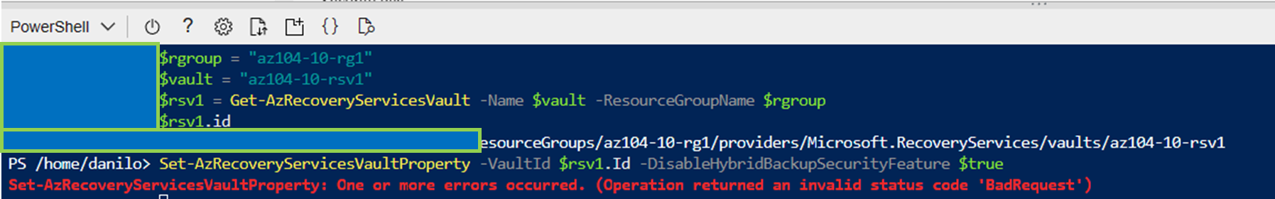

    Now when I try to disable the Soft delete for hybrid workloads running the below command: Set-AzRecoveryServicesVaultProperty -VaultId $rsv1.Id -DisableHybridBackupSecurityFeature $true I face the below error: User's image
