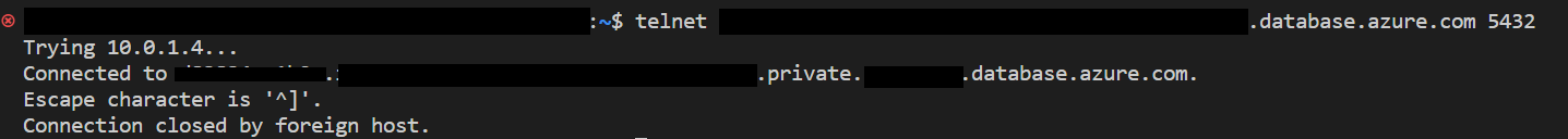

I cannot connect to an Azure PostgreSQL Database flexible server from VM on same VNet. The database server has the following configuration:

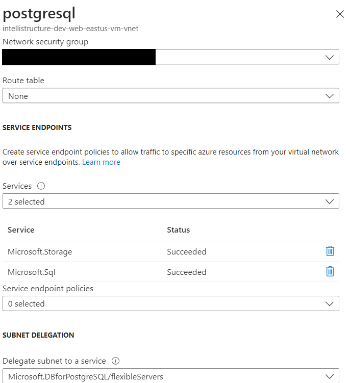

  • Subnet: Different subnet since the subnet has to be delegated for use only with PostgreSQL Flexible Server

  • DB Subnet with Microsoft.Storage and Micrososft.Sql services endpoints selected. Private endpoint network policy is set to Network security groups
  • VM Subnet with Micrososft.Sql services endpoints selected. Private endpoint network policy is set to Network security groups

When I run the psql command to the PostgreSQL DB the command hangs. I tried using the IP, FQDN, Private DNS zone name, and record set name of the record which appears to be the DB. I noticed when I look at the Connected Devices of the VNet I see the VM but not the DB even though the DB is on a different subnet of the same VNet.
