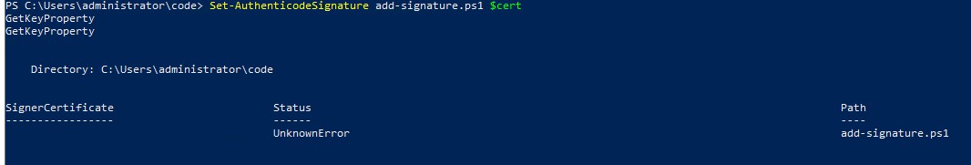

Am hitting a bit of an issue when trying to sign some powershell scripts, I am following this basic articlehttps://learn.microsoft.com/en-us/powershell/module/microsoft.powershell.core/about/about_signing?view=powershell-7.3
I am using certificates from my own PKI, the root and issuing CA certs have been imported into the machine trust stores and the code signing certificate is valid, the issue comes when I run the step to sign the powershell script, I get an unknownerror.
CodeSign Screenshot 2023-04-03 120345

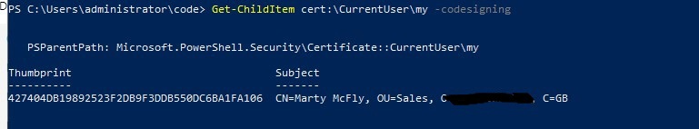

If I run the following I do see my code signing cert in the cert store
code signing list Screenshot 2023-04-03 121131

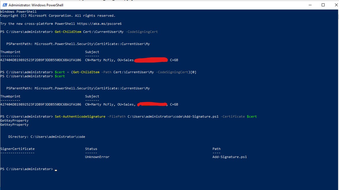

    Looking at the description of the Set-AuthenticodeSignature, both the scripts' path and the certificate both have a "Position" value of 1. That may be an error in the help file, but why not try using the parameter names?
    Set-AuthenticodeSignature -Path add-signature.ps1 -Certificate $cert

  3. Gary Nebbett 6,436 Reputation points
    2023-04-04T07:21:37.41+00:00
    Hello Michael, Can you check the following two things:
    1. Details of the signing certificate.
    2. Whether a signature has been added to the .ps1 file
    I just tried the sequence of commands that you used and got similar results. In my case, the certificate "properties" (external to the certificate, can be modified) enabled all "purposes", but the certificate did not contain an "Enhanced Key Usage" or similar extension specifying code signing.
    The .ps1 file was modified, but PowerShell also tried to verify the signature and ETW tracing showed that this failed because of "A certificate's basic constraint extension has not been observed.".
    Your problem may differ in some details from mine, but the essence might be the same.
    Gary
