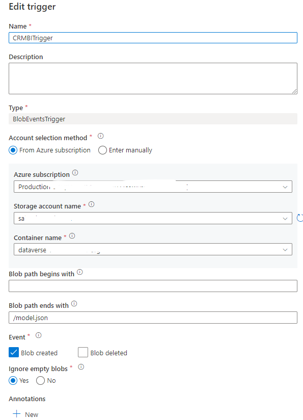

I have set up a trigger in fact I have done everything it says to do in https://learn.microsoft.com/en-us/power-apps/maker/data-platform/azure-synapse-link-pipelines?tabs=synapse-analytics.
But I have noticed it is sometime missing the step DaterverseToSQL. Is there any reason for this. I have checked the folders and they have data in them but for some reason it is not pulling the data over.

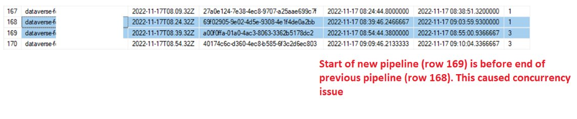

    A record was created and included in incremental folder 1. The same record was later edited and included in incremental folder 2. Processing of incremental folder 1 failed, while processing of incremental folder 2 was successful. After a rerun, processing of incremental folder 2 was still successful. Which values of the record are current? Those from incremental folder 1 or 2
    When Orchestrator Pipeline encountered unexpected error and failed for the given folder (Incremental folder 1). ThenDataverseToSQLPipelineProcessingLog has entry of 0 (failure) for the failed folder. Then subsequent folders (eg: Incremental folder 2) will be marked as 3 (skipped) and not as successful (1). As the previous folder are not successful (status code <> 1), hence all the subsequent folders will be skipped (Status code = 3). To avoid this skipping folder loop, please follow below resolution steps:  ​

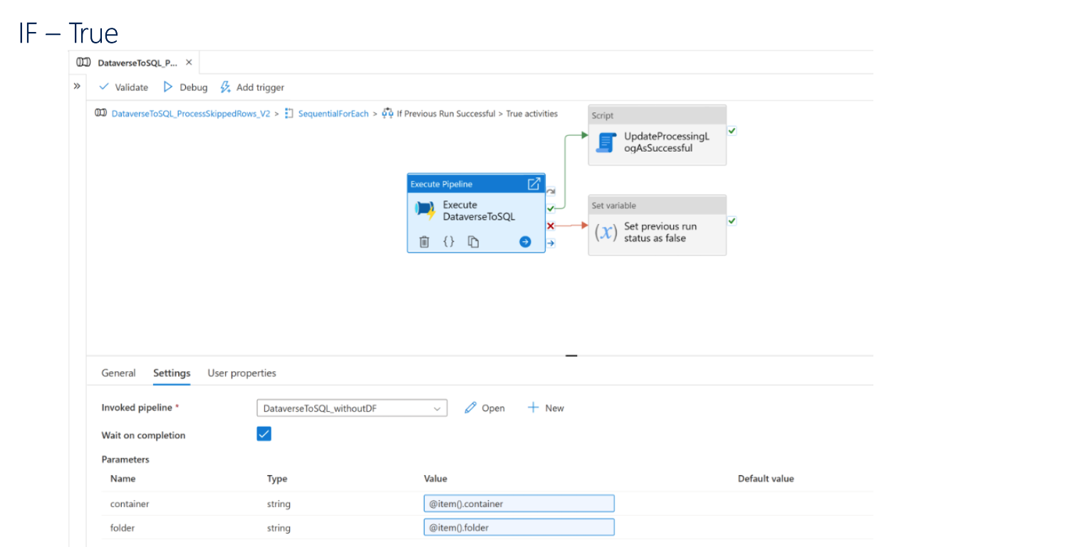

    Yes, in that case to avoid manual effort, please consider having new pipeline which: ​
    1. Retrieves the skipped folder chronologically​.
    2. Executes the DataverseToSQL pipeline sequentially​.
    3. Updates Status column of DataverseToSQLPipelineProcessingLog rows to 1 (success). Below is sample view of the pipeline looks like for processing skipped folders: User's image User's image User's image User's image User's image User's image

    Important Note: If the pipeline getting skipped without any failure, then it means that prior pipeline runs for previous folder are failed (status = 0) or skipped (status = 3) due to pipeline execution time overlapped as shown in below image.
    To avoid the execution time overlapping, as I mentioned in my previous posts, it is necessary to set the concurrency = 1 for your orchestrator pipeline, that way only one execution will be in progress until completed and the subsequent pipeline runs will be queued and executed in the chronological order. Ensuring that Concurrency setting of Orchestrator pipeline is 1 will avoid this scenario in future. I will also provide feedback to the document/template owner to update the template in such a way that by default concurrency is set to 1 from the template gallery.

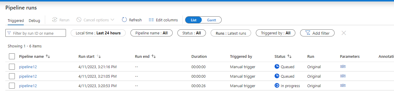

    As called out by Ray Chung, when previous pipeline runStatus = 1 then the Execute DataverseToSQLPipeline will be triggered.
    Could you please set your pipeline concurrency to 1 and see if that helps to resolve the issue. This setting will ensure that the previous pipeline run is completed before the next pipeline concurrent run is starts the execution, until then the latest pipeline runs will be Queued. Please note that there is a limit here, max pipeline queued size is 100 and if goes beyond that then the subsequent runs will be failed. User's image
